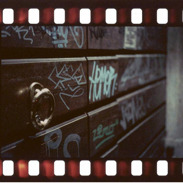

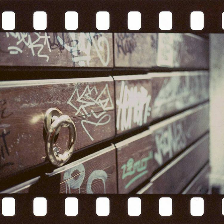

Rollei gives also an example to show the speed variation like here :
This should be a little joke of Rollei - shouln't it ?

The central shot looks correctly exposed. The top and bottom look typical of about half-to-one-stop over- and under-exposure, as they might on most slide films.
