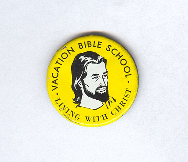

I know that the people who bother to make & use pinhole cameras tend to be divergent types so I thought I'd ask, what's the most "different" pinhole you've ever made? In the interest of science I'm posting a pic of mine: a pinhole "lens" that's the eye of Jesus.

Shooting from a Christian point of view... heh (hahahah)
That's one interesting way of "coloring" your images :wink:

Poptart, I don't know if this means you're genuinely righteous, or an evil blasphemer.
Fortunately, I don't particularly care... :wink:
