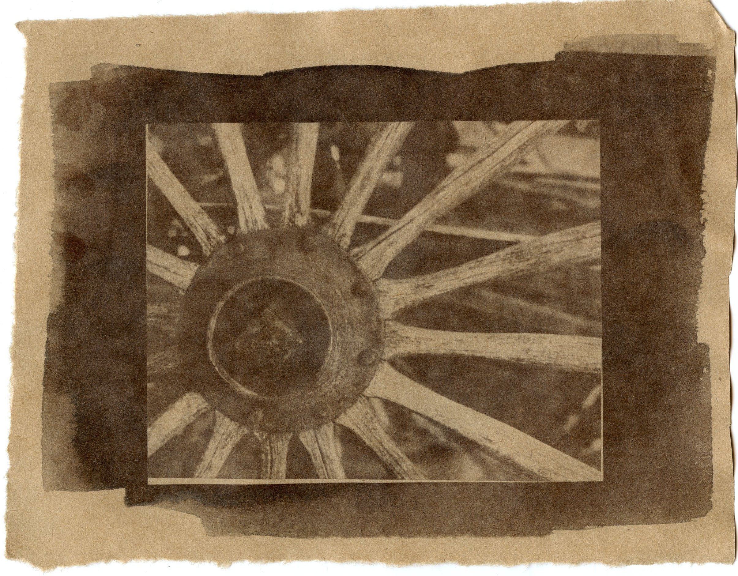

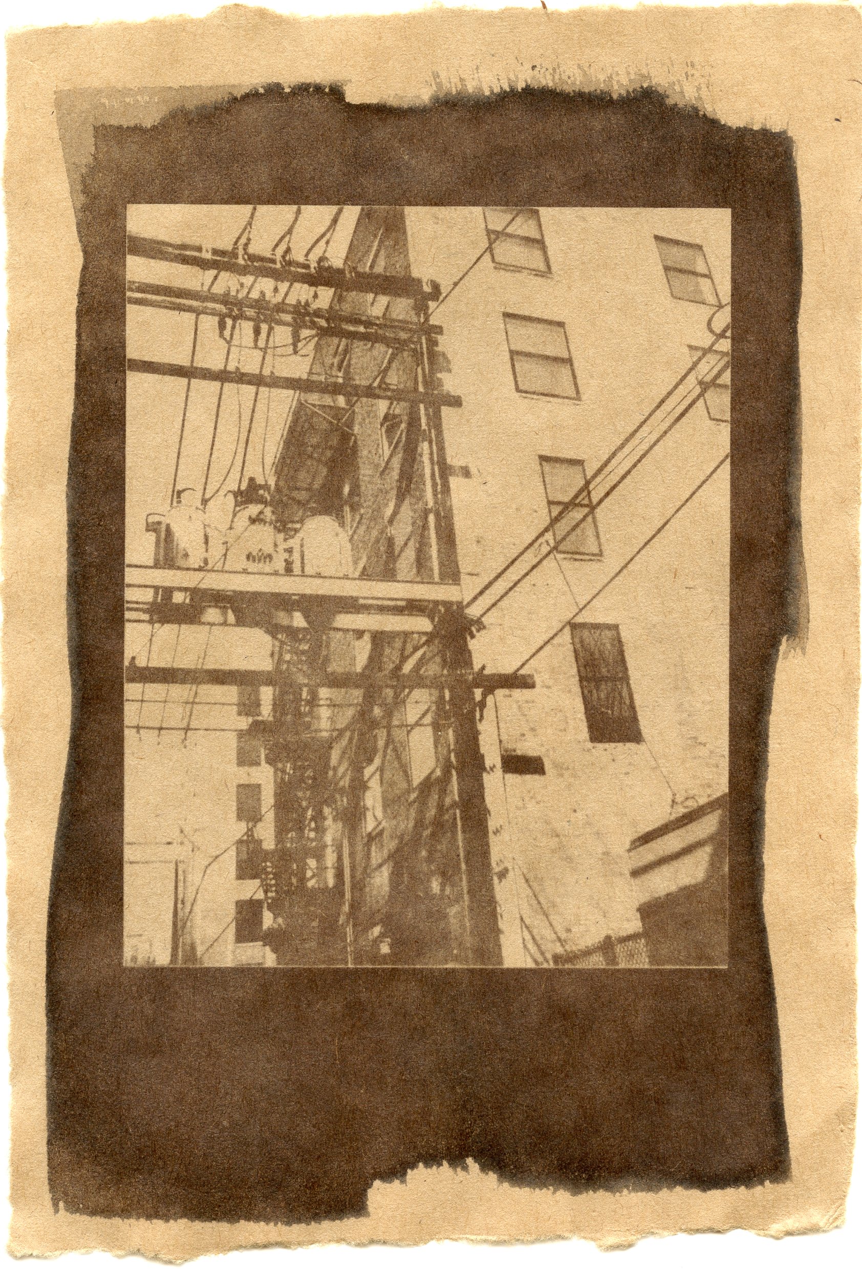

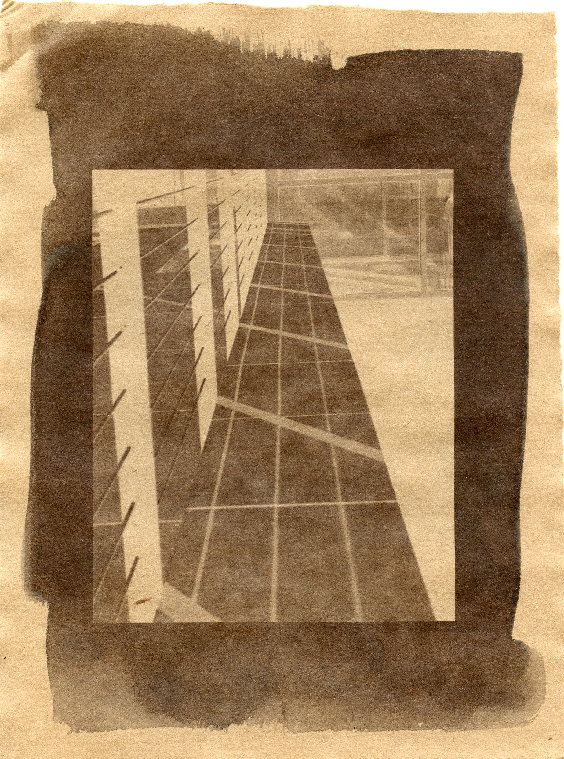

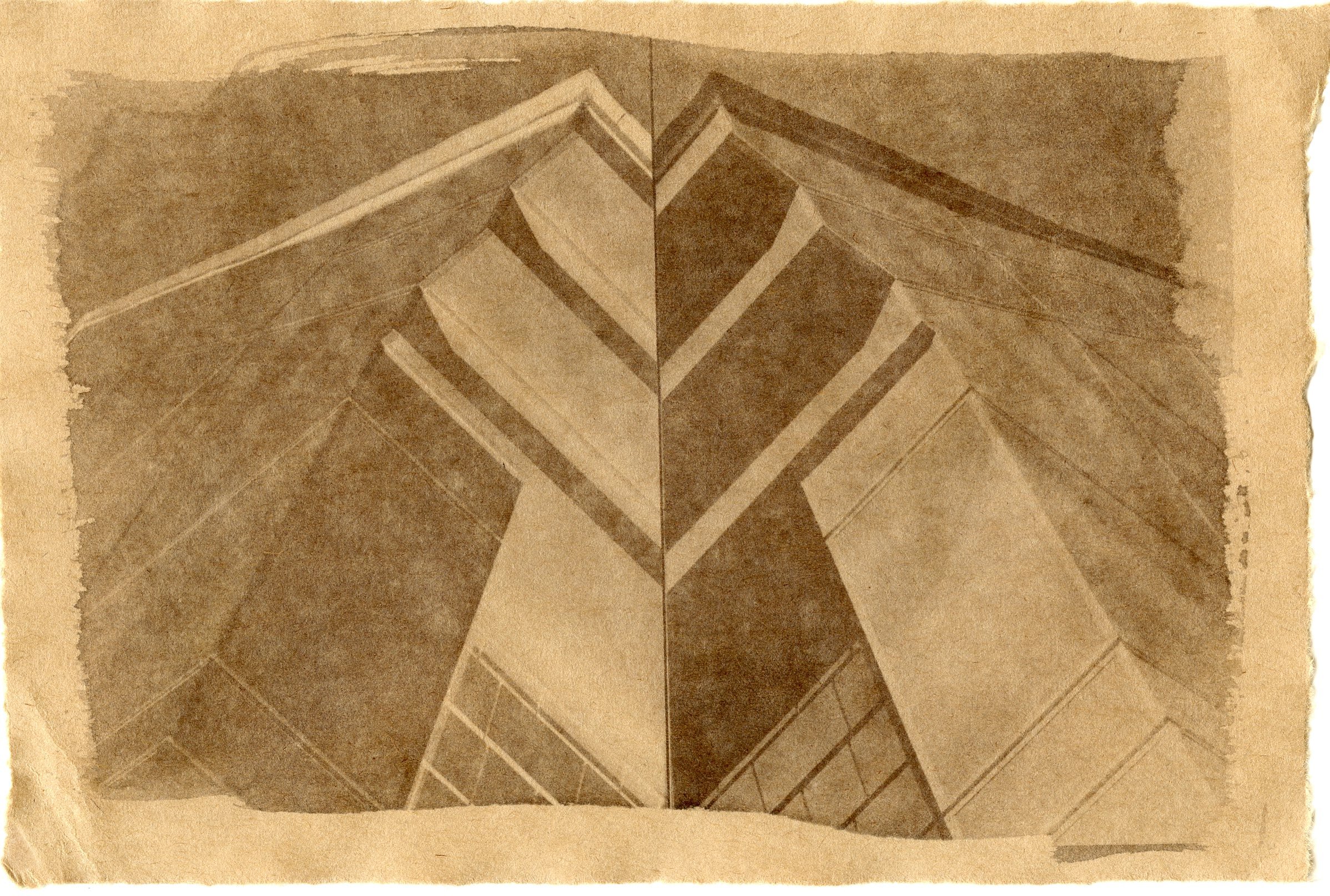

I mentioned that coating cyanotype sensitizer on craft paper caused it to turn blue right away. I am doing some Van Dykes and, while I am generally using watercolor paper, I decided to see if the same issue occurred with Van Dykes sensitizer on craft paper. It doesn't.
Here are some samples. I did notice that the density of brown is not as intense as on watercolor paper but it could be related to exposure. I use the sun and yesterday we had none and the occasional skiff of snow.
I also noticed that applying cyanotype sensitizer to a finished Van Dyke will dissolve the Van Dyke image.
revdoc
Apr 12, 2015
291
Cyanotype sensitiser contains potassium ferricyanide, which bleaches silver images, especially images made of very small particles, like a VDB. Many reducers and bleaches (including Farmer's) use it as the main bleaching component.
That means you can print a VDB over a cyanotype, but not vice versa.
