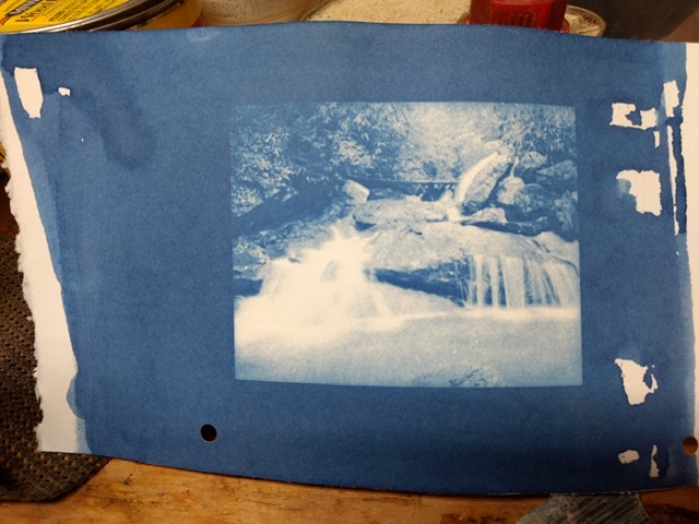

Im just now playing with cyanotype, and hearing beforehand that cyanotype sensitizer will bleach out a van dyke I decided to try out the other way around. First thing I learned was the cyanotype partially bleaches back when applying the sensitiser, second thing is the paper absorbs way more sensitizer after its been wet and dried. I did get a decent amount on the paper enough to see how the process will work. Its in the dryer now and I hope to expose it this evening. Anybody been through this themselves and what did you learn?
When I exposed it I couldn't see very much of the blue, but after the first wash and going into the fix I saw blue coming back. After a quick rinse I put it back in the peroxide tray and the blue came back a lot stronger. The blue looks blotchy though, I dont know if that can be corrected. You can see the van dyke detail in the shadow areas. Obviously the exposure levels of either can be manipulated up or down to change the character of the image.
I tried another experiment with interesting results. I had wondered what would happen if van dyke and cyanotype sensitizer was mixed, so I took a chance on one part A, one part B, and one part mixed van dyke sensitizer. After the coated sheet dried I exposed it with a negative I had tried previously with cyanotype exposed the same amount of time. I processed it in a similar fashion to a van dyke with a water bath, fix, then I put it in a weak peroxide bath to amp up the blue.
Interesting result was a much lower contrast cyanotype look with very little sign of any van dyke influence. The print on the right is the
pure cyanotype. Any guesses as to why it did this?

No, I didnt see any precipitates but the solution had a deeper orange tint than usual.
Looking at the 2 images a little more, it is interesting that the left one (made with mixed sensitizer,) in addition to looking faded with much lower Dmax, is also actually much lower in contrast and it shows the highlight details much better than the pure cyano on the right. It is a better image overall.
It would be a good image if the Dmax hadn't suffered. I would wonder if a pure cyano printed on top of that will hold up.

Dmax got nicely better as would be expected...did the highlights get washed out some compared to the original or is it due to digital reproduction? Are you using acidic bath for 1st wash or plain water? The former should help retain the highlights as it would also boost the Dmax.
I used an acidic bath, just a little stop bath dribbled into the water bath. I think the perceived contrast may make the highlights look a bit brighter. As far as I can tell the original detail is still there. Kinda reminds me of split filter printing, combining a high contrast and low contrast exposure.
That must be it....eyes can deceive.

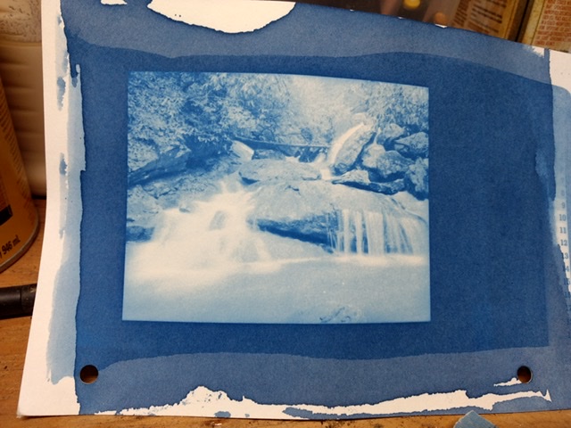

This gets me to thinking the silver in the van dyke solutions is not entering into the fray but the other two ingredients, tartaric acid and the fac may in fact be making all the observed change. I would suspect the tartaric acid being the culprit as the extra fac in this case is not that much. I’ll have to experiment with adding just one of the van dyke components and see what effect shows up.
Sounds like a plan.
I tried out the tartaric acid 4.5% with the A and B parts one part each and it seems this may be the component causing the changes. I exposed it ten minutes like the previous images, rinsed it in a tray of water with a few ccs of stop bath in it, then into a tray of water with a small amount of peroxide splashed in it. Before rinsing the area under the neg was dark blue but the area around was an ashy looking blue grey along with several shadow areas on the image. The grey look disappeared in the peroxide.
Looks like you have found it. This print looks almost identical to the first one - slight difference in the tint but that could be the camera, but the tones are pretty much there. If I remember correctly I had a similar outcome when I added oxalic acid. At the time I was trying to do the opposite, i.e. get lighter highlights and darker shadows so I didn't pursue it further.
There was some solarization due to formation of Prussian white in the high UV exposure areas, hence the grey. Peroxide converts Prussian white to Prussian Blue.
:Niranjan
Does the presence of prussian white mean I should reduce the exposure? This may well also reduce highlight detail.
Its digital on pictorico, so its a clear substrate all around the image. I should have dropped a stouffer scale on the paper when I printed it.
OK, I get it. I was under the impression this was an in-camera negative.
To answer your earlier question: No, if you see solarization, that does not automatically mean it is over-exposed. As a matter of fact for Sun exposure, that is how folks check whether exposure is done. i.e. look at the shadows and when they solarize or reverse tones, it is an indication that the print is adequately exposed.
In your case, there is very minimal difference between the negative border and the area at-large outside of it. I can see only a faint difference at the top. So if I have to guess, your exposure seems to be right or close to it. You can check it the old fashioned way by exposing strips with above and below the nominal on the same sheet with your negative and see which one gives the best Dmax without losing highlights. Since you added the tartaric acid, the correct exposure can very well be different than that for the normal recipe, so ideally a new stouffer-like print should be done to make sure.
