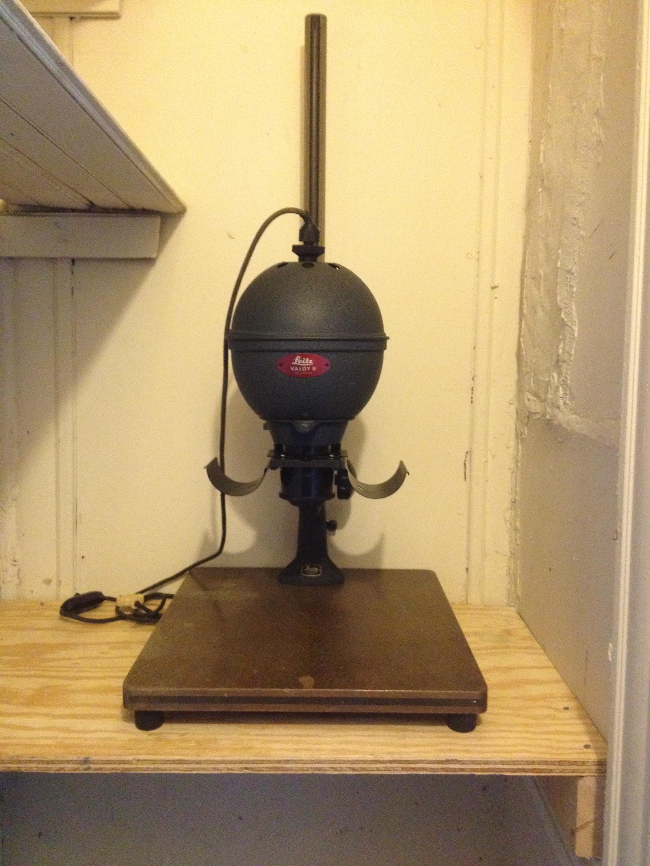

Hey everyone, just got a Valoy ii, beginning to start building my in home darkroom. Just had a few questions about the machine. I need to get a replacement bulb, I noticed it has a standard light bulb mount, is there a standard bulb that would be sufficient? Also, i need to get a timer for the light, if any suggestions. Thanks!

75w bulb will do a perfect job. I use cold lamp to save power or dry some diffused LED bulbs.

Re the bulb, yes an enlarger lamp for sure. Best would be a socalled shortneck bulb, with a bit of effort you can find these. I have that in 150watt in the Valoy II.

75W enlarger lamp. It's a PH 211. There are also 212 lamps that are 150W.
