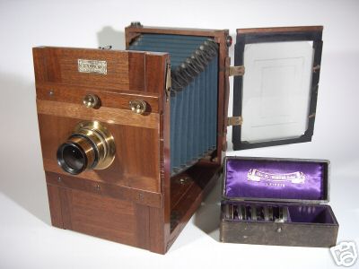

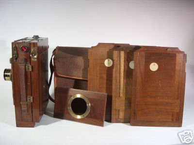

My new old toy has arrived.
The camera itself is a beautiful, but fairly simple (and thus lightweight) 13x18cm "Reisekamera". But what made me buy it was the "accessory", a full set of Chr. Fr. Winter Sohn Aplanat Objektivsatz, seemingly identical to the Busch Vademecum Satz No. 2: Seven lens cells of focal length 15, 25, 35, 45, 55, 65 and 75cm all fitting in a common lens barrel.
I like Aplanats, I'm going to have some fun with these :smile:

Ole,
enjoy your satzobjektiv, but test it to have the real value of your Aplanat.
For my experience with satzobjektiv (I'm an avid collecto) you could have surprises. Some lenses are meniscus some other periscop type and you will find some slightly differences.
I'm a lover too of pre-anastigmat lenses and I really don't understand all these premium prices for so sharp lenses :wink:

These are definitelt Aplanats - it's a very simple construction to identify by reflections. Inner and outer surfaces curved the same way with somewhat similar curvature (front a little stronger than rear); and then the cemented interface with very strong curvature in the same direction.
BTW - I have a Periscop lens to play with as well: A Voigtländer WZ...
