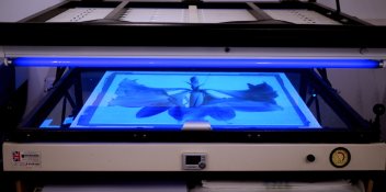

You might want to test out the unit before buying, when i started looking at these types of a units quite a while back i experienced problems due to the fact that the uv tubes were set at a fixed distance and could not be modified resulting in uneven expsoure and what seemed to look like some sort of 'uv burn' on the final print. there might be a way around this but like I said see if you can test one that would be best.

On that link you posted i tried the model at the bottom which is beige in colour.
Ideal distance with my own set up, shown below is approx 9 inches, bulbs 1 3/4 inches apart.
On a budget others options are to create a uv exposure unit yourself with uv tubes in a wooden enclosure, instead of using a vacuum use a heavy sheet of glass, will work upto 11x14 inches any larger you really need a vacuum unit to maintain sharpness across the print.

I lustfully looked the picture of your setup, looks fabulous.
But if the bulbs are at the top facing down onto the paper, how does your vacuum work??
(I use a huge UV box at the Print Studio for polymer photogravures which has vacuum on top on a hinged lid, and bulbs below. The plates are placed face down facing the UV bulbs, and the top lid closed, then the vacuum seal is used to hold plate flush to glass).
Yep, it really was a stupid question - have answered it myself...! :whistling:
