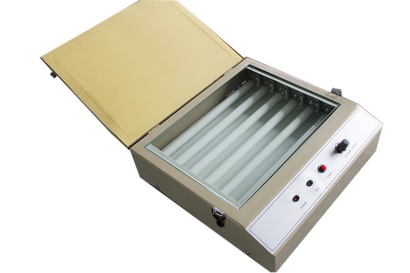

I've attached a picture. due to forum rules I'm still not allowed to post links. here's the parameters:
Exposing area: 10.2"x8.3"(260x210mm)
Voltage: 110v
Time Range: 0-550 seconds
Light power: 48W?six 8W UV fluorescent bulbs )
Machine size: 12.6"x12.5"x4.3"(320x317x108mm)

If you're satisfied with 8x10 prints, that looks like it would work very nicely to get started. One thing to make sure of is if you can find replacement bulbs (and to replace them all at once when you do.).
9 minutes might not be quite enough exposure time, so you might need to set the timer and run twice. Or strip out the built-in timer and use a Gralab 300 or other timer to control it.
EDIT--Based on the specs and dimensions, I'm guessing the bulbs are F8T5/BL, which are pretty common, and reasonably-priced.
EDIT2--Found a couple of people selling units that look like this on the 'Bay from $120 to $150. Seems a little expensive. But you'd be hard-pressed to source 6 bulbs and an appropriate ballast for less that $50, so maybe... Just bringing this to the attention of the crowd, since the OP can't post a link to the listing.
