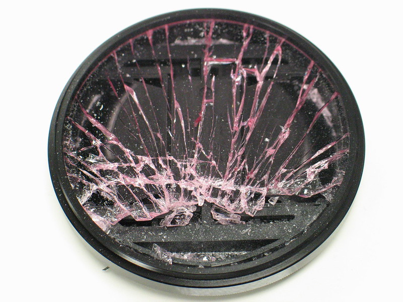

The filter shown below did not survive the fall on concrete – the camera and lens did.
There are two photographic groups or camps – those who routinely use a filter to protect the front element of their lens and those who do not.
I was once a firm believer in protecting the front element of my lenses with UV/Haze filters. However, when I evaluated the results of an image quality test I was conducting between two 35mm high-resolution black & white films (H&W Control VTE film and Kodak High Contrast Copy film), I switched camps.
During the test, I shot a tripod-mounted camera with the mirror locked up and with a UV/Haze filter. I also took some shots without a UV/Haze filter. When I noticed that even a high-quality UV/Haze filter caused some loss of image quality, I removed the UV/Haze filters on all my lenses because I needed to capture as much detail possible in my large prints. Since then, I no longer use protective filters on my 35mm lenses, my Mamiya medium format lenses, or my large format lenses. Since then, the only time I use a UV/Haze filter is when I actually need it to reduce UV light (such as when shooting film at high altitudes or in snow) or when I need to protect my lens from damage while shooting in a hostile environment (such as when shooting mud wrestling or food fights, in storms or industrial plants, or dirt bike and horse races).
When I need a filter to protect my lens, I use a medium or a high-quality filter. I avoid the reasonably priced low-quality filters because they degrade the image too much for my taste.
Filter for lens protection
by Narsuitus, on Flickr

As far as protection goes, thin glass filters really only offer protection from things like dust, grit, and spray.
If you're relying on a thin piece of glass you can probably break with your bare hands to protect your camera gear from a forceful impact, then you're probably asking it to do something it is entirely unsuited for...
If you want to protect against drops and such, try a lens hood that can act as a crumple zone for your camera and absorb the energy. Or try not dropping camera gear in ways said gear isn't likely to shrug off easily?
I was actually surprised at the toughness of the filter glass. I had an old filter that I didn't need--I think it was a Tiffen UV--and I needed a thread extender to get a lens working on macro rail/slide duplicator, so I decided to sacrifice the filter. I placed the filter on a work bend, and hit the glass with the but of a large screwdriver to shatter the glass. It took quite a few hard bangs before it cracked and then significantly more effort to crack the glass to the point that I cold pull the shards out (after which I saw the ring I could have unscrewed to remove the glass without breaking it...) While I don't use a "protection" filter on my lenses, it did make the protection part make more sense.
