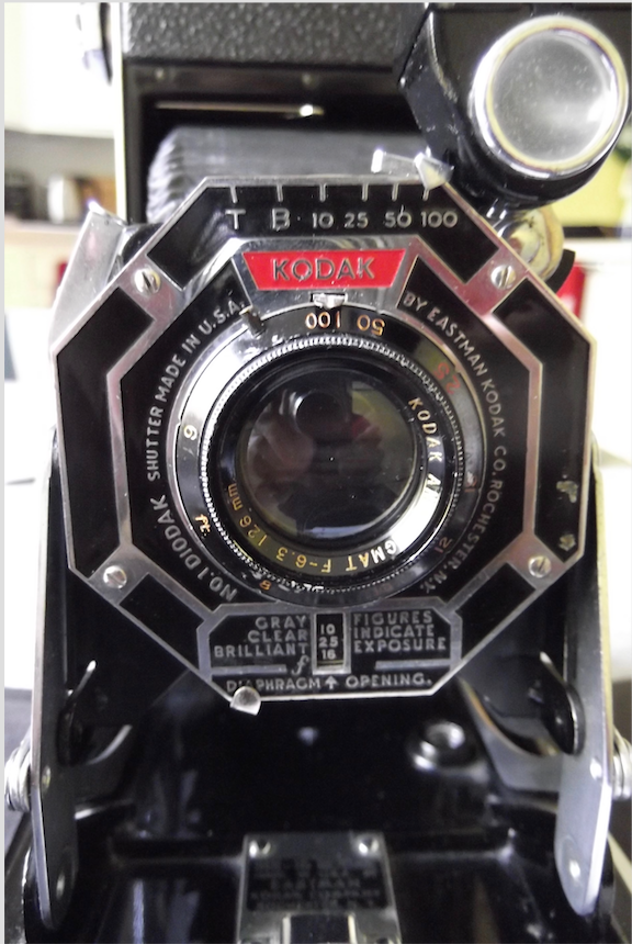

I recently returned my dad's 1932 Kodak Six-16 to use. Rather than fill out this whole thing I'll just post a link to the blog I did.
Short answer-- it's a really lovely camera capable of excellent work within its limitations. If you have one sitting around I strongly urge you to give it a whirl. Spacers to use 120 film cost about $10. That and trim the 120 spool with some nail clippers and you're in business:
https://charlestrentelman.blogspot.com/2020/10/original-kodak-six-16-shooting-present.html

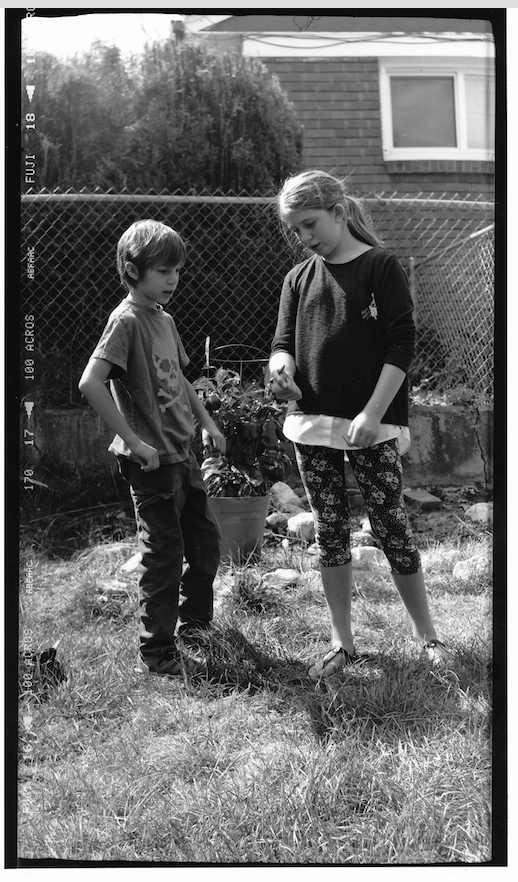

Sample pic
Here's a scan of a darkroom-made print. These are really nice negatives to work with:

yeah, and it makes it a LOT easier to get the finished roll out of the take-up side, but instead of that, if you have a toenail clipper it is very quick/easy to just trim the plastic 120 spool edges down -- takes less time than re-spooling. Don't even need to smooth the edges.

I have a Kodak Junior Six-16 Series II. Sent it to Sandeha Lynch and he replaced the bellows. I've used a couple of times and really like it. 1/100th top speed takes some getting used to though.
I use a 616 spool to "pull" the film through the camera off the 120 spool. Two US quarters work as spacers to keep the 120 spool centered. Works just fine. I take the film out in a changing bag when it's time to develop.

I have one but sadly the metal bit that turns the take up spool won't stay "in" the spool when I advance it. I was pretty gutted... I purchased spacers for it, too. I'll take another look at it to see if there is a work around... Cheers, and thank you for posting your image!
The mechanism is held in by friction in the area that the metal bit passes through to the outside key. Perhaps you can bend it in that area to increase the friction.
Bend it towards the film or away from it?
I don't think this is a good thing to try to do through the internet!
See if you can see how the camera puts friction on that key - the friction that keeps it in, and then resists when you turn or pull it to release the key from the spool. The part that creates the friction is what you want to consider bending slightly.
