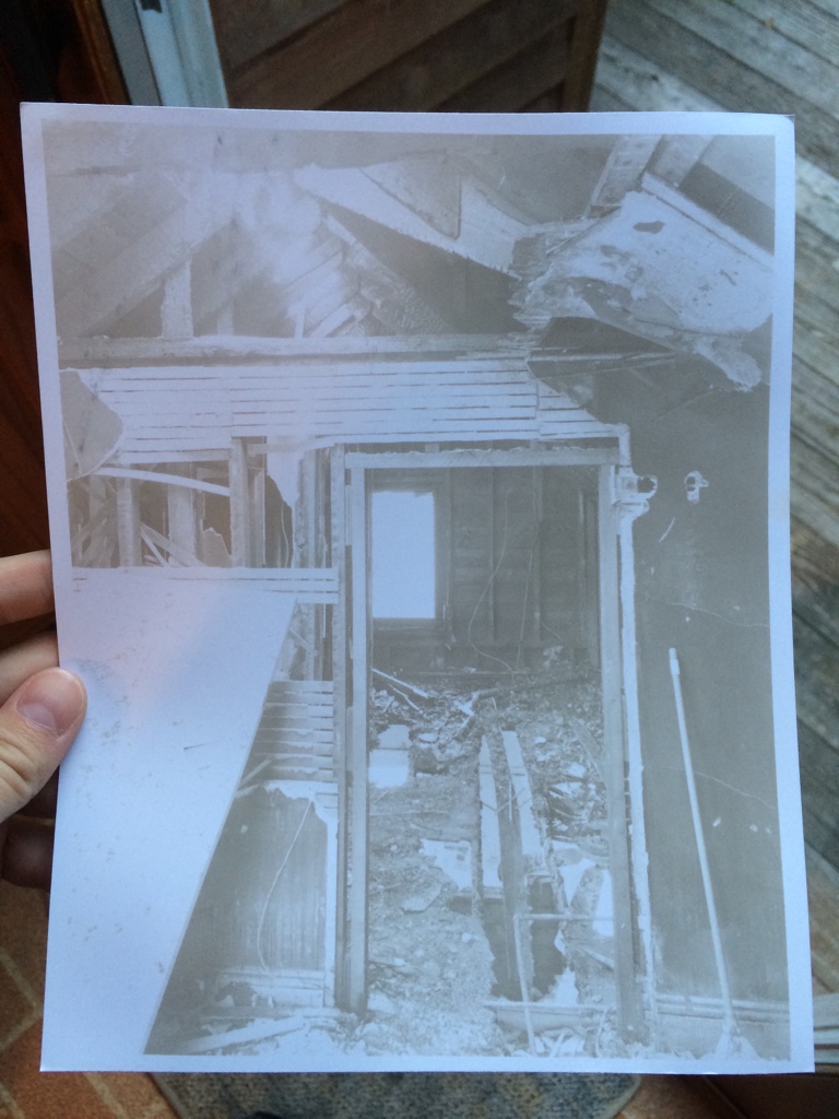

I once saw a Rodinal advertisement that gave different dilutions for both film and paper, as well as plates and lantern slides.
So I decided to do my own experiment and see if the new version of Rodinal, since that ad was probably from the early turn of the century (1900's-1940's?) was before revisions were made to the developer we still use today, would print.
I used both an RC type paper and a FB/Rag type paper.
Both gave a print image but both were weak and the images were sort of brown not black.
Is it the Rodinal that changed or the paper? Or the actual emulsion on the paper itself?
Thanksz

Hmmm this is actually the dilution I try to use, and almost nothing came out but a very faint image, so I added more to the batch and made it something like 1 to 10, and that seem to develop something very very slowly, but I had to leave it in the developer for about 10 to 15 minutes.
This was A pile that was at my school, so it's entirely possible that it's lost its potency and has gone bad and that's why you didn't work, I can always bring in a fresh batch to see, it worked but it was very difficult to get an image out of it and they're very faint, not strong blacks or anything, it also tried over blowing the image a lot, and it seem to have almost no effect on the contrast it just seem to stay the same just to help you over a very long time, The last image done on the fiber-based paper instead of a resin coated paper was left in for almost an hour, and I got an image but it certainly wasn't strong.
If it's simply a case of the developer being bad, I'll go and try again using some fresh developer, Terry what dilution did you choose? I tried 1:80 and then 1:10 and the 1:10 seemed to work but again it could have gone bad?

The paper is certainly fresh, I'm thinking this Rodinal is bad... It's the schools so students might have screwed it up, it's also AGFA Rodinal so who knows how long it's been there LOL.

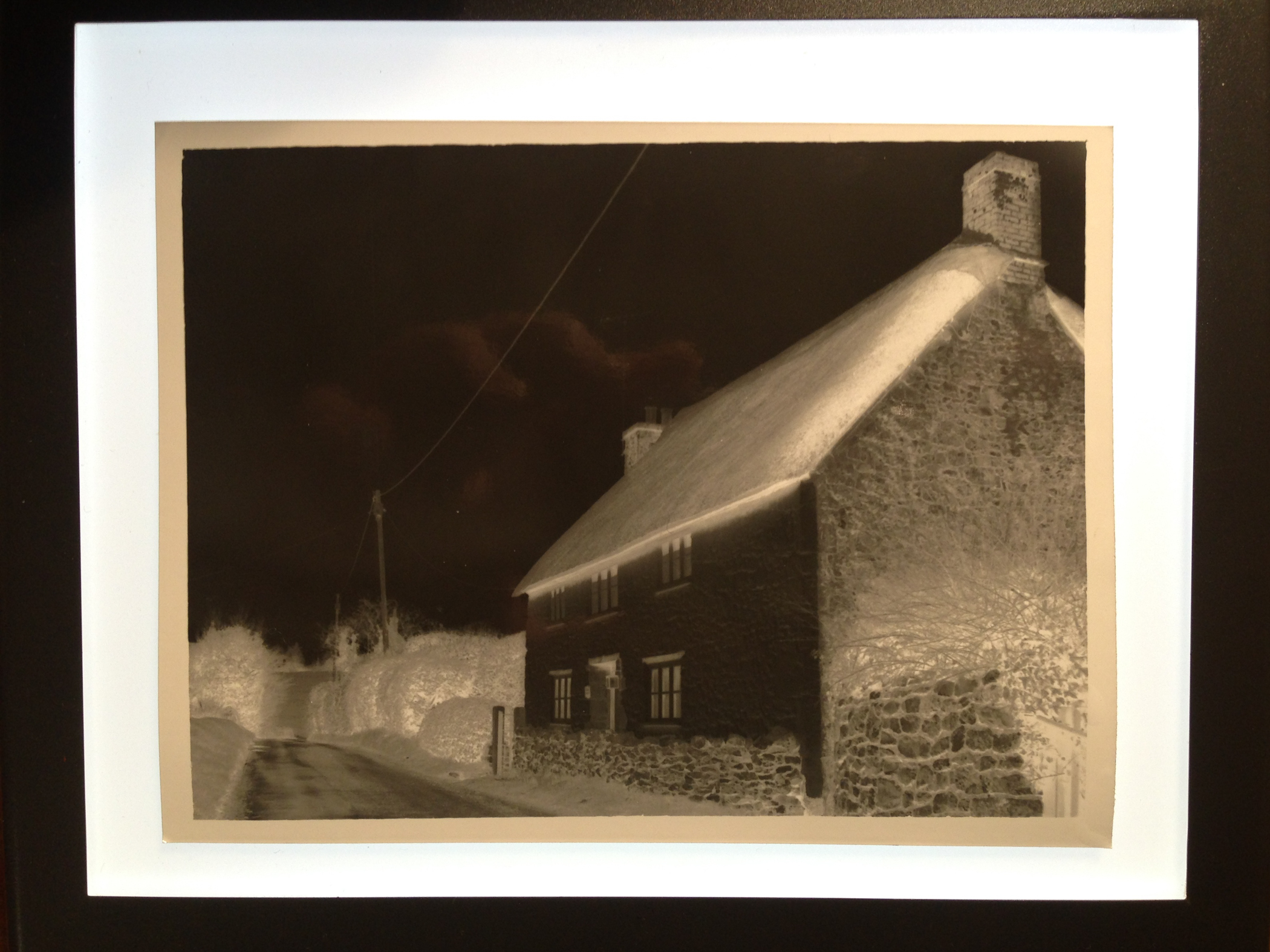

Thanks to this thread, I just resurrected my 1896 Underwood 'Instanto' 1/4 plate camera and shot a couple of paper negatives in it again (something I've not done for years!). I have some Rodinal that I've been developing my Fomapan 100 in recently and I was very pleased with the results developing the paper in it (paper neg on the lightbox shown)...

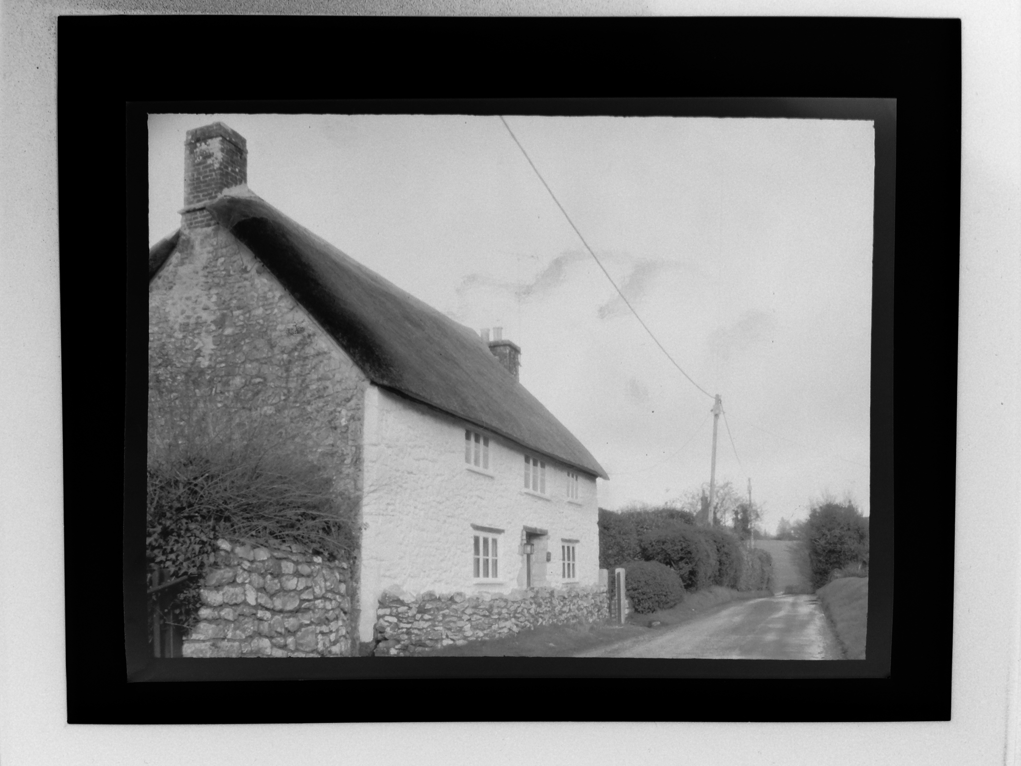

Just tried developing paper in Rodinal again (at 1+20) with good results. Exposure was guessed at 20 seconds with yellow / green filter fitted to the Underwood Instanto 1/4-plate camera (original lens).
Reversed in Lightroom (recently moved house and haven't got the enlarger up and running yet!)...
