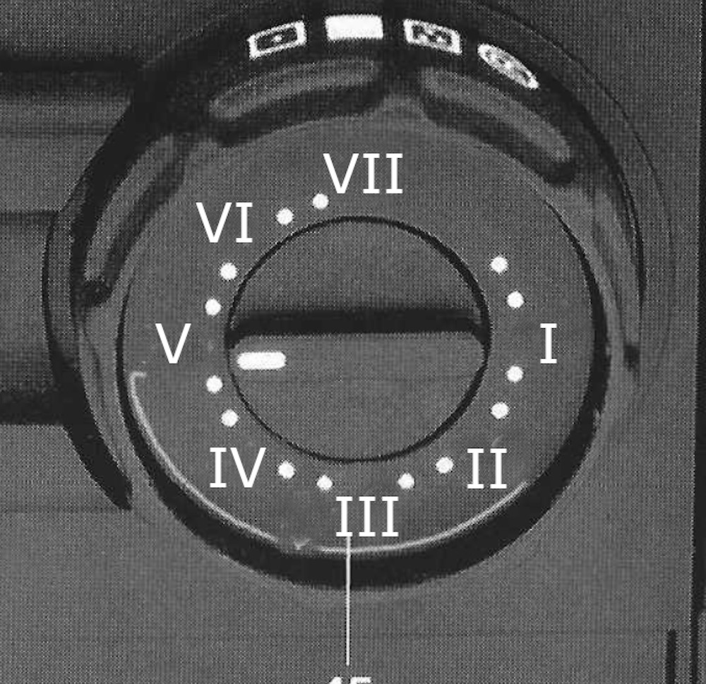

It is nice to have a scale in cases where it is not always obvious. Like my Sekonic, where, if using exposure comp as as the zone, it goes in reverse. Coincidentally 2.5 is the same.
Also, the Rollei built-in spot meter, where zones might not be obvious without a sticker:
