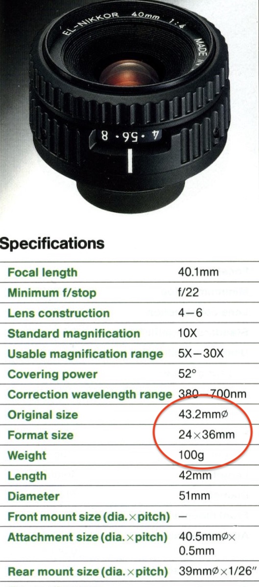

Would welcome some advice. I have acquired a Nikon 40mm enlarging lens. So far I have used it to print half frame. Is there anything to bear in mind if using it as a 35mm wide angle for printing larger from 35mm full frame.

According to this brochure it is a wide angle lens for 35mm format enlargements:

Mine has given me excellent results in 35 mm enlarging. It is rated for 5X to 30X. The 50 mm f/2.8N version is rated for 2X to 20X. The 40 mm lens gives greater magnification than the 50 mm lens for the available projection distance.
For example, for a 600 mm distance from the negative to the image, the 50 mm f/2.8N gives 9.6X. The 40mm f/4N gives 12.7X.
I see no corner cutoff with this lens wide open at any magnification I’ve used. Per the data sheet as given in post #2, it should “see” a circle of 43.2 mm (the diagonal of the 24 mm x 36 mm frame of a standard 35 mm format) up to 30X. I’ve used mine up to 22X, usually at an f/5.6 aperture.
