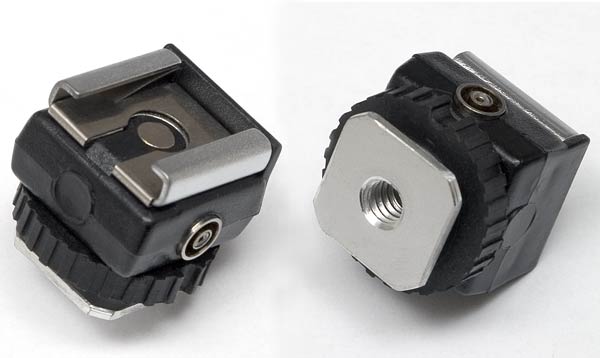

Grab one of these:
I use one of those with either a flash directly or a YN remote trigger in it connected to a large format leaf shutter.
