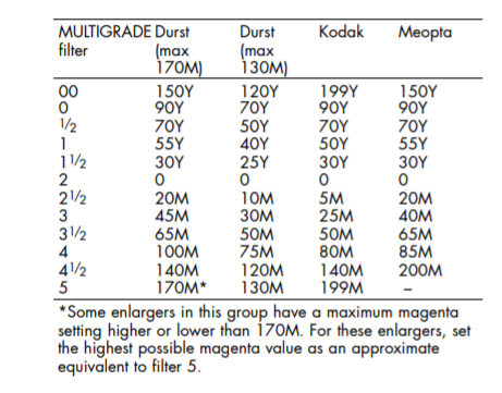

Ilford Multigrade manual:
"OTHER VARIABLE CONTRAST ENLARGER HEADS
The contrast of MULTIGRADE papers can be controlled with the range of variable contrast enlarger heads that are currently available. Some of these are easier to use than others, and several give excellent results. Many manufacturers make variable contrast heads for their enlargers which are specially designed for use with MULTIGRADE papers. Enlarger heads that have been designed in conjunction with ILFORD include those from De Vere, Dunco, Kaiser, Leitz, LPL and Meopta. For use with MULTIGRADE papers, follow the instructions provided by the enlarger manufacture!"
ambiguous...

Iford Multigrade manual:
That is very detailed information as we would expect from Ilford for which I thank you. I did not even know there was an actual Multigrade manual :smile:
However, it says exactly nothing specific about the Foma contrast filters.
Would you interpret this as saying: the Foma filters should work fine with the Ilford papers?

The above Ilford statement is ambiguous and also applies only on the Multigrade heads.
But from Meopta:
"Meograde
Meograde head is a device of black and white gradation scale Multigrade photographic papers."
The Meopta colour heads employ neither the Durst nor the Kodak scale, but the Agfa scale.
Here Ilford say:
On the Meopta variable-contrast foil filters I got no information.
