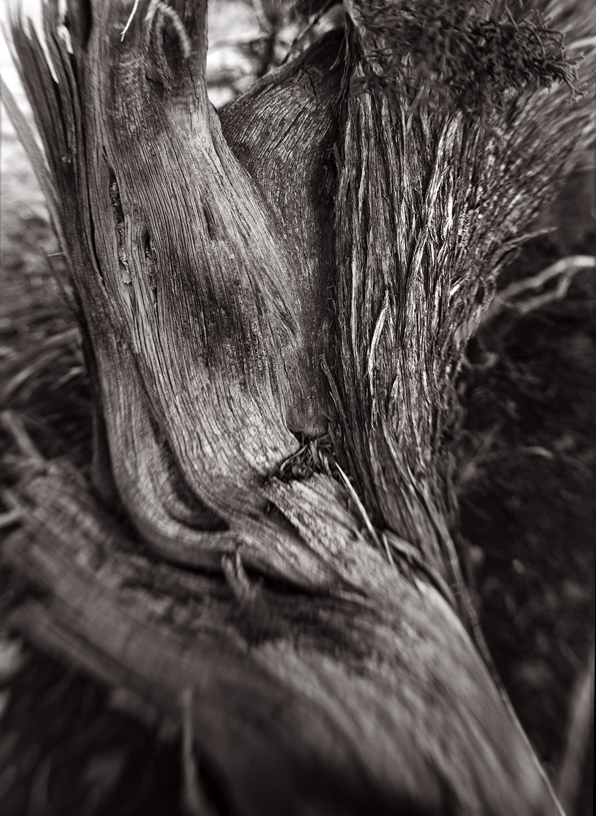

This is just a quick note about using the lenses for a Medical Nikkor as a casket lens set for large format photography. I’ve been playing with this idea for a while. Found a shutter that allows me to mount the lenses on either side of the shutter/diaphragm, which makes this easy to set up. The complete set, which were used as interchangeable front elements on the Medical Nikkor lens to give different reproduction ratios, will provide focal lengths from over 2000mm to about 50mm. That’s if you use only a single, or pair, of the lenses. The Medical Nikkor says that you can use as many as 3 of the lenses together, which would further extend the range of the lenses. I believe each of the lenses is a cemented doublet, coated and reasonably well corrected. The lenses are marked 1/8, 1/6, ¼, ½. 1x and 2x, but this doesn’t correspond to anything but the reproduction ratio of the Medical Nikkor lens. I am working with a set from the original 200mm version of the lens. Anyone have any experience with these as large format lenses? I am including 2 shots made with the ½ lens behind the shutter and 1x in front. These were close to the subject which gave considerable bellows extension. Ilford Delta 100 film processed in xtol. Thanks for your attention

Looks interesting. Reminds me I should have - or at least have had? - half a set (or something) somewhere in the attic. What was the resulting focal length for your sample shots? Would it be the no.1 Compur shutter to fit?

I used an old shutter that has about a 1" aperture. The focal length at infinity for the 1/2 & 1x together is about 5 inches at infinity. I used it at about 8 inches and about 11 inches. Because the aperture is about 1 inch all I need to do is measure the used distance between the shutter and the film and use that as my wide open aperture, so 8 inches for the stump photo, and stop down from there. I was shooting at an aperture of f64 for the stump photo, at least that was the aperture for the exposure. I hope this makes sense? I think the shutter would be closer to a #0. Thanks John Siskin

Thanks for this info. I think I gave up on trying to use the lenses as objectives on account of the resulting short focal length, and no suitable shutter. But your results are very nice. I suppose they would be equally suitable for color.

The bokeh on that tree trunk looks really interesting. I can’t figure out exactly what’s going on with it. It’s not swirling but still has some movement, maybe some kind of distortion in the axial direction?
Not sure but it looks really cool.
Hi T, I think the lens has some really interesting effects with the out of focus areas. This is the 1/2 behind the shutter and the 1x in front. At infinity it might cover 5x7, but at full aperture all but the center of the frame would be soft. In these shots there is considerable bellows extension because the subject is so close. Also the lens is stopped far down. It will take quite a while to be aware of the possibilities of this set. Thanks for your attention

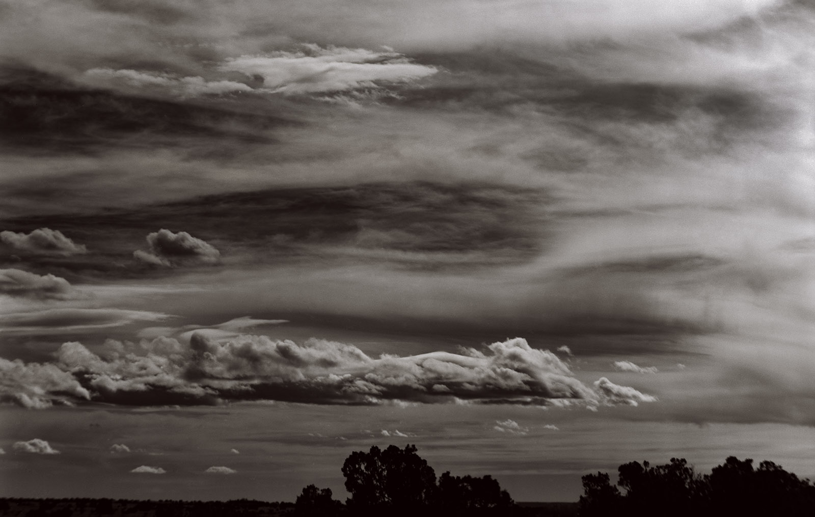

This is another shot made with the new, to me, Burke & James 5x7 camera. The camera is actually more than 60 years old. Anyway, I was using the front elements from the Medical Nikkor there are more than 40 possible combinations of these lenses, unless you use 3 elements which would give you many more. It’s a little like having a zoom lens on digital camera, sort of. I think this shot demonstrates that considerable sharpness can be achieved. I was using the 1/2 element behind the shutter and the 1/4 element in front. Aperture was about f56 and shutter speed was 4 seconds. I was shooting Ilford Delta film, processed in xtol. Thanks for your attention

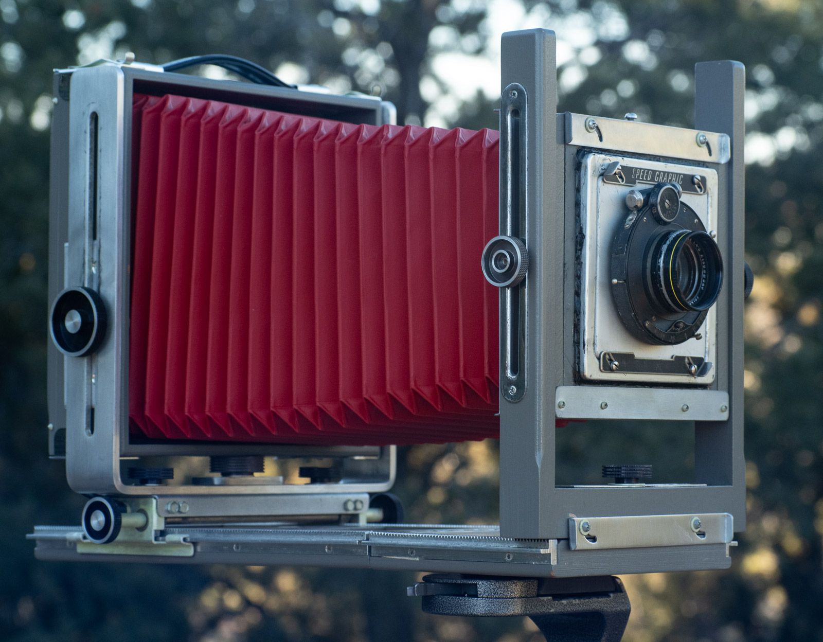

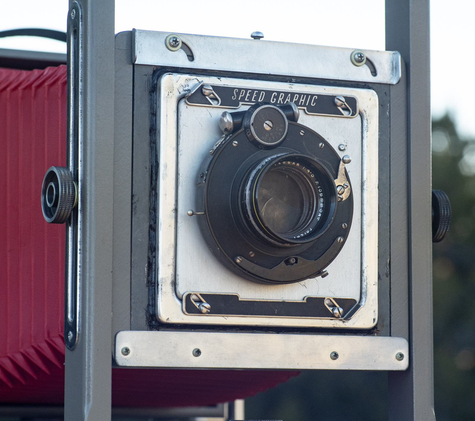

I had a request to post a picture of the set up for the Medical Nikkor elements for large format use. You can clearly see the conversion board I built to use Speed Graphic lens boards on the camera. I’m also including a picture of the Burke and James 5x7 camera. for a camera that is at east 60 years old it’s in remarkable condition. Of course I’ve recently posted some pictures made with the camera and lens. Thanks for your attention

Nice camera! Also seems to be the exact twin to my first 'real' LF-camera, acquired abt. 50 years ago in a pro-shop in Copenhagen. I still use the 5x7 back on another camera. Incidentally am a bit confused by the lens set-up. Seems you have screwed the M-Nikkor lens into the filter thread of the old Tessar (4.5 - 135/150mm?) in old no. 2 Compound shutter. Did you use the M-Nikkor lens as a close-up add-on, or have you removed the lenses of the Tessar entirely? Just curiousl
JohnSiskin
Jan 27, 2007
42
Indiana
Remarkable cameras. Quite tough! I removed the glass from the lens. Didn't need another tessar. The medical nikkor elements fit into both side of the shutter. Right now I am keeping the 1/2x element in back

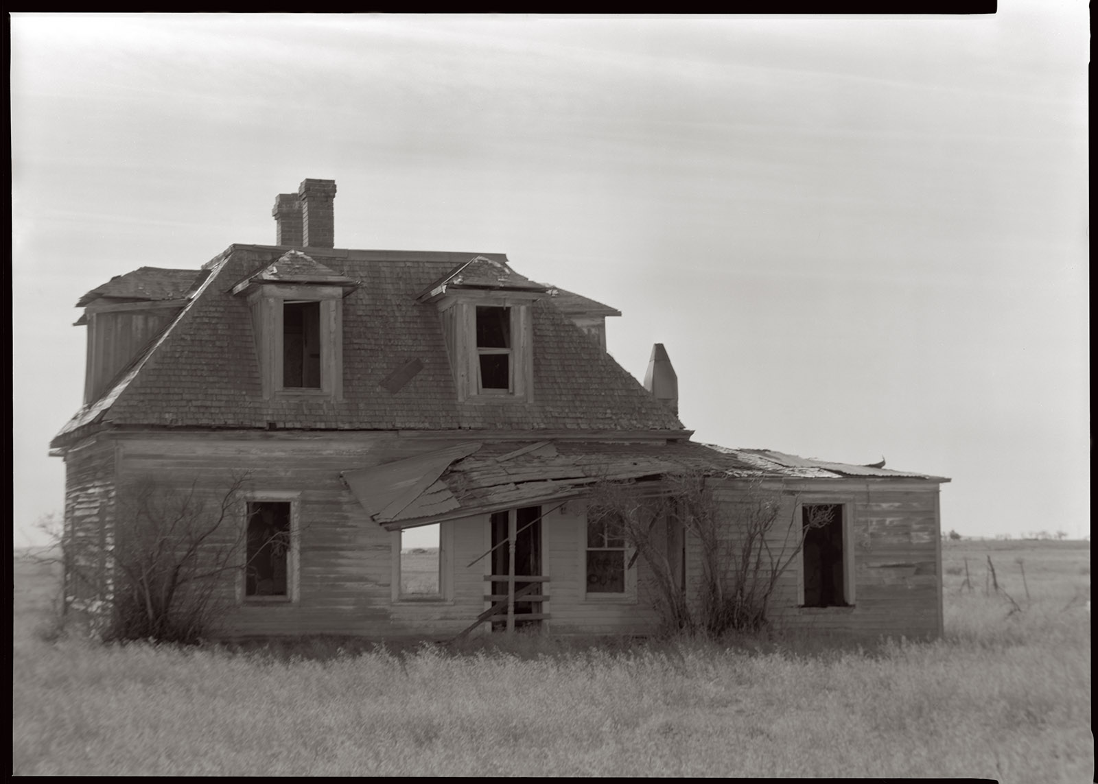

I might have been in Estancia, regardless, abandoned house. I used the Burke and James 5x7 camera with the Medical Nikkor elements. The 1/2 behind the shutter and the 1/4 in front for a focal length of about 14 inches. Gives the image a nice feel. Ilford Delta 100 film processed in xtol. Thanks for your attention
