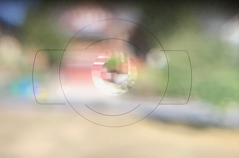

I replaced the standard focusing screen on my Pentax SF1 with a salvaged split image screen from a Miranda EE, the SF1 has interchangeable screen, all I had to do was cut the Miranda Screen to fit with a Dirmal grinder attachment . There were also after market split image screen made for various AF bodies.
