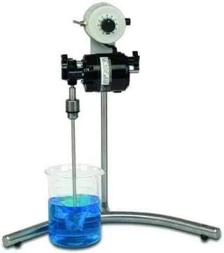

As long as the vortex doesn't drag in air. I use a prop type mixer, variable speed. Magnetic stirrers in a laboratory setting are used for titration.

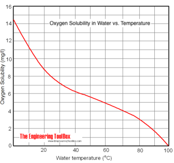

The hotter your water, the less oxygen is dissolved in it. (Thus the bubbles that form on the inside of your water glass as it rises to room temperature.) So, if you're worried, boil it, let it cool, then use it. Even hot water from your hot water tap will have less oxygen dissolved in it than water from your cold water tap.
Interestingly, from the same source as that graph, water more readily dissolves oxygen than it does nitrogen.
If oxygen didn't dissolve easily in water, it would be a problem for a large part of aquatic life…

I worked as a bench chemist for 30 years. Mag drive stirrers are not designed for mixing bulk powders. Look at the old photos of Kodak operations. Lightning mixers and other direct means are preferred.
