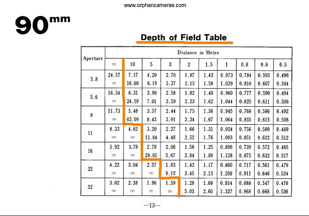

I carry around lens charts for each of my RB67 lenses. Attached sample is for the 90mm lens. I marked off hyperfocal points for quick reference of where to set my aperture and distance. I'll often stop down one more stop for good measure.

Alan Klein
Dec 12, 2010
1,067
New Jersey .
The hyperfocal distance is a distance you focus the lens to which will give acceptable sharpness from half of that distance up to infinity.
Steve.
It varies depending on the aperture. See the sample chart in my last post. You'll notice that at smaller apertures it could be 1/5 or a lot closer than 1/2.
