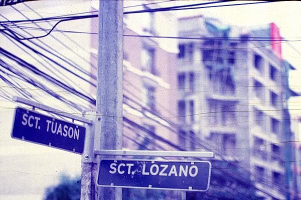

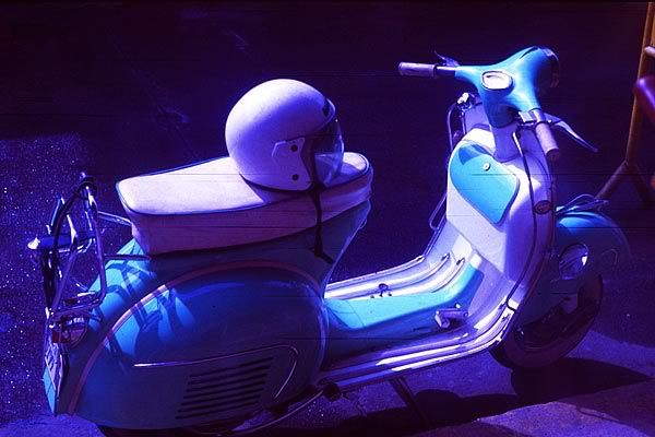

Thanks for the replies. Below are two frames from the clip-tests I made, processed in not-so-fresh E6 chems (just past rated capacity):
Really Blue. The abrasions seen are from the makeshift methods of holding short strips in a developing tank.
@ R.Paul, I had considered using an 85 filter to neutralise the film's halogen lamp balance. I saw your samples- there appears to be a bit of blue left, but I think that's manageable for experimental or special "artistic" :tongue: purposes.
Looks much much better than it has any right to considering you're using out of date film and almost depleted chems.
The Vespa has a cool daytime / nightime thing going on.
Shoot and post some more :cool:
