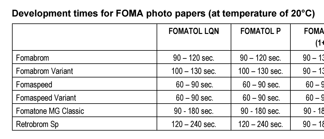

The development times for foma papers (including fomaspeed) are on the Fomatol P datasheet : https://www.foma.cz/en/catalogue-fomatol-p-detail-408
