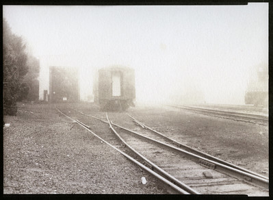

Fog is easy here. Just look out the window this time of year.
Unfortunately, my few attempts to photograph fog came out looking like......fog. That was it, just fog.
