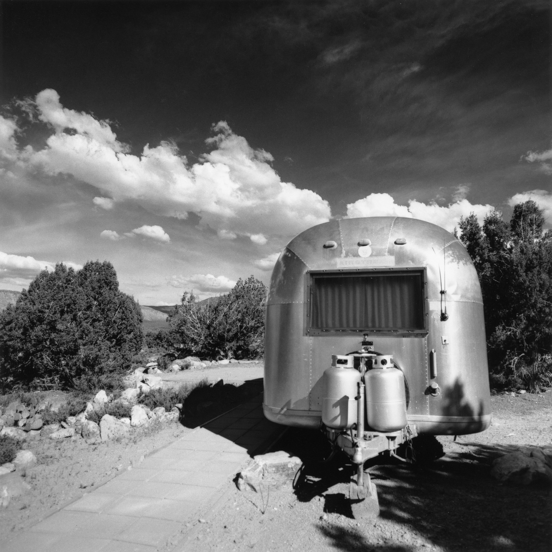

To each his own. I would think a red filter plus a polarizer would give you a very dim viewfinder image (I know the 50 is f2.8, but even then) and possible unpredictable results depending on how certain colors might be affected. I find the orange filter plus split-grade printing and burning the sky can give me dark enough skies. This is with the 40mm.
Very nice picture. I prefer not to dodge and burn the sky around complex shapes. I don't always use both, but I like having the option. I don't expect the darker viewfinder image to be a problem because I often (mostly) use these filters with lenses that are slower than f2.8. It hadn't occurred to me that it could be a problem with this lens and camera. I'll know soon enough, I guess.
