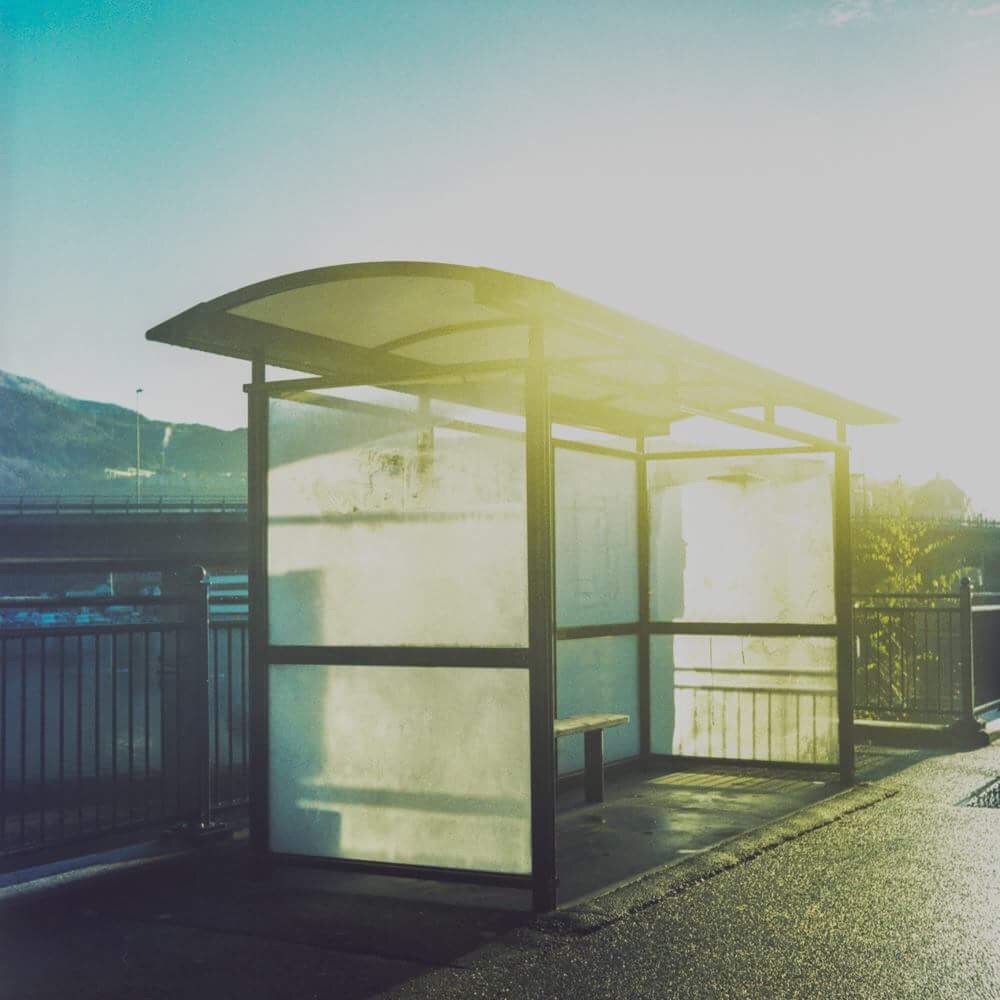

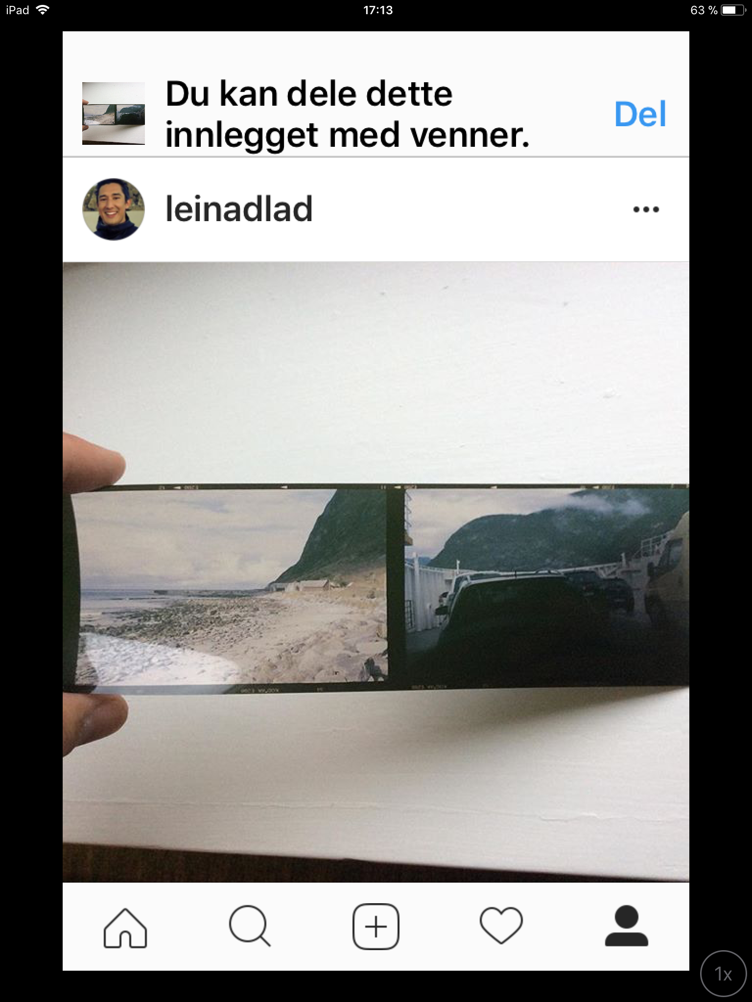

I was gifted some e200 that expired a decade or two ago. The first I shot at 100 and had e6 processed at a lab. Results were good.
The rest I’m shooting at 200 and cross processing as c41 with a two stop push, the first of these was fogged, I think I may have screwed up the processing on this roll though as I’d just swapped to a Jobo machine,
the others look better, but I haven’t been able to print yet as our colour ra4 machine is broken.
The bus stop is scanned from the fogged roll. The positives are the Instagram shot and the building is the most recent. Will try to upload one pic of the negs from this batch, just have to reduce it first.

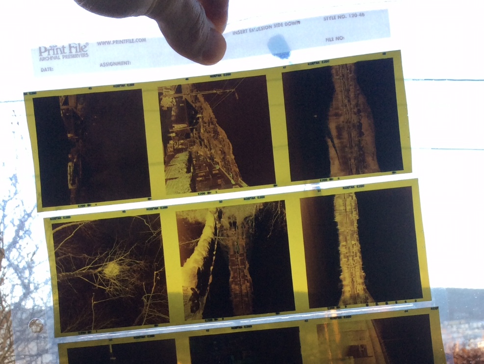

Latest negs.
