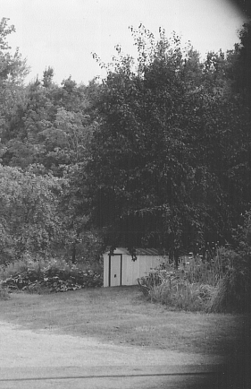

I've done it
I used a cheapo 50mm f3.5 el-omegar that I got in a box ..one of the smaller variations not that it matters
Used a LTM extension tube set piece that gave pretty close to correct flange distance
focused on scotch tape to eyeball different distances with a turning out of the extension tube
It worked OK
90mm would be more difficult. Focussing is much more involved. I've tried that too but not with an enlarger lens
It worked OK as well
I attached a photo using the 90mm Ektar at like f5.6 at distance of 130ft+-
cheap scan of print
Half of the photo cause neighbors had a pile of junk and bricks next to their garage
vignetting due to too small aperture of lens adapter
No photo using enlarger lens but I guess I could post something one of these days without too much trouble
It works
Not for a prima donna, of course
I actually tried this out to test the feasibility of a 35mm enlarging lens
Focus is more easily controlled but finding one that covers 35mm cheaply is more difficult ..not that I've tried.
35mm Russian is perhaps $60 but that's $60 I'd rather use elsewhere
50mm lens is even cheaper so not worth the bother
