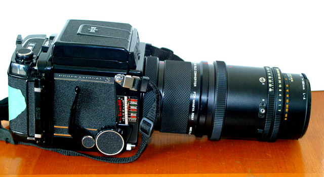

And just for the fun of it, this is an RB67 with 180mm lens and 2x teleconverter:
Unfortunately, that's now an f/8 (ish) lens. Better have some lights. I've got that combination, though I haven't shot the 180 yet either with or without the converter. I have shot my 250 mm with the converter; kind of disappointing (but I'm not likely to save up for a couple years to get either a 360 or 500, so on the rare occasion I need a lens longer than 250, the 180 or 250 gets the converter).
