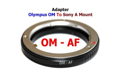

It is possible to mount your Olympus OM macro on your Dynax 9xi .
No AF ( obviously!) and no automatic aperture, but still useable.

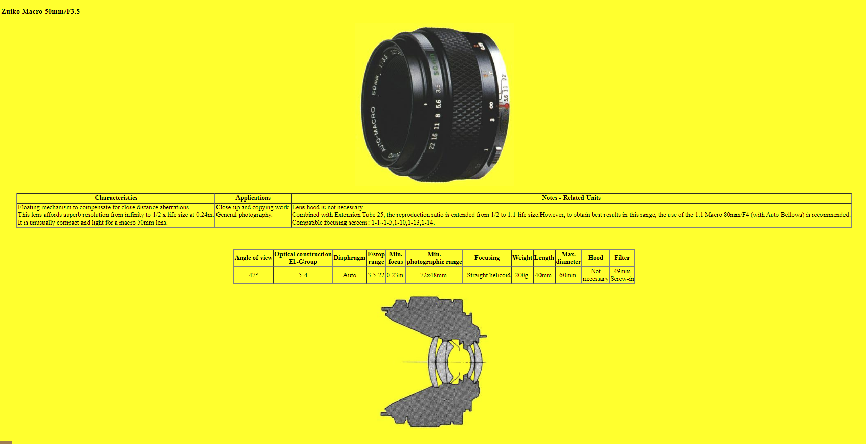

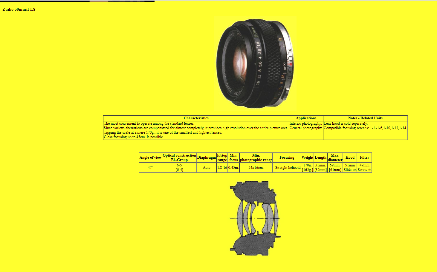

If you compare your lens with the 50mm f/1.8 lens which was the basic, standard lens, you may notice some differences. From the wonderful Olympus OM Sales Information site:
The 50mm f/1.8:
The 50mm f/3.5 macro:
In terms of practical concerns:
1) The 50mm f/1.8 is smaller and lighter;
2) The 50mm f/1.8 focusses more quickly, because it requires a much shorter turn to go from infinity to normal over even close focus;
3) The 50mm f/1.8 is two stops faster;
4) The 50mm f/3.5 rarely benefits from a lens hood, due to its deeply inset front element, while the 50mm f/1,8 benefits from one. Both are well coated for their time, and reasonably flare resistant;
5) There seems to be a fair number of 50mm f/1.8 lenses out there that have sticky apertures in need of cleaning. That may be due to the fact that there are a lot of 50mm f/1.8 lenses out there.
As far as results are concerned, the floating element construction allows the macro version to perform very well at all distances. And the 50mm f/1.8 lens, as well as its wonderful older sibling, the 50mm f/1,4, are excellent performers at all non-macro distances.
