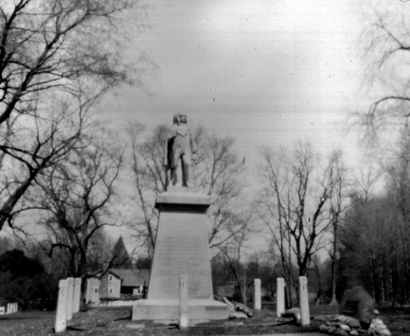

Below are two 4x5 pictures shot from the same point, at two different bellows lengths.You will have to excuse the quality of negative processing as I was having a bad day in the dark room.
The first picture is with the bellows focal length set at 4.6" (11.7cm) and a .018" (.46mm) pinhole. giving and aperture of about f256.

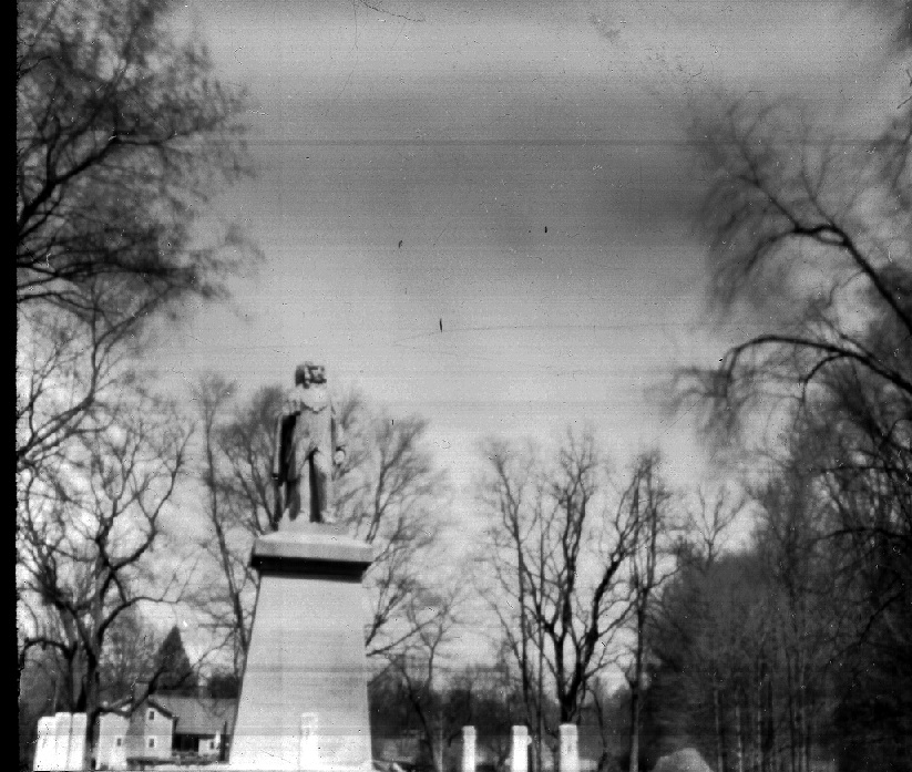

The second image is with the bellows extended to 6.48" (16.5 cm) with the same .018 pinhole, for an aperture of about f360.
You can see that by moving the bellows out you spread the pinhole projection, thus slightly enlarging the image cast onto the 4x5 film.
The second image my be a tad sharper do to the smaller aperture but the quality of the negative leaves much to be desired. I only posted them to give some idea of what extending the bellows one f stop would do. While it is true that there is a optimum pinhole size for each aperture, I have no less than three sources giving me three different "correct" formulas.
