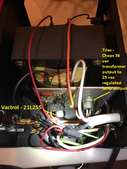

This may or may not be like yours. Based on this picture of a 120V Beseler Dichro power supply, and the sales literature, there may not be 220V terminals for the primary winds of the transformer. Having mentioned that, you could check your 220V transformer and see if it has 120V terminals.

I think the original idea was to use a voltage converter to feed the enlarger's power supply the voltage it expects. Should work fine as long as it doesn't need too many amps. If the 23CIII uses 25V lamps, though, there shouldnt' be a problem with replacement bulbs.
