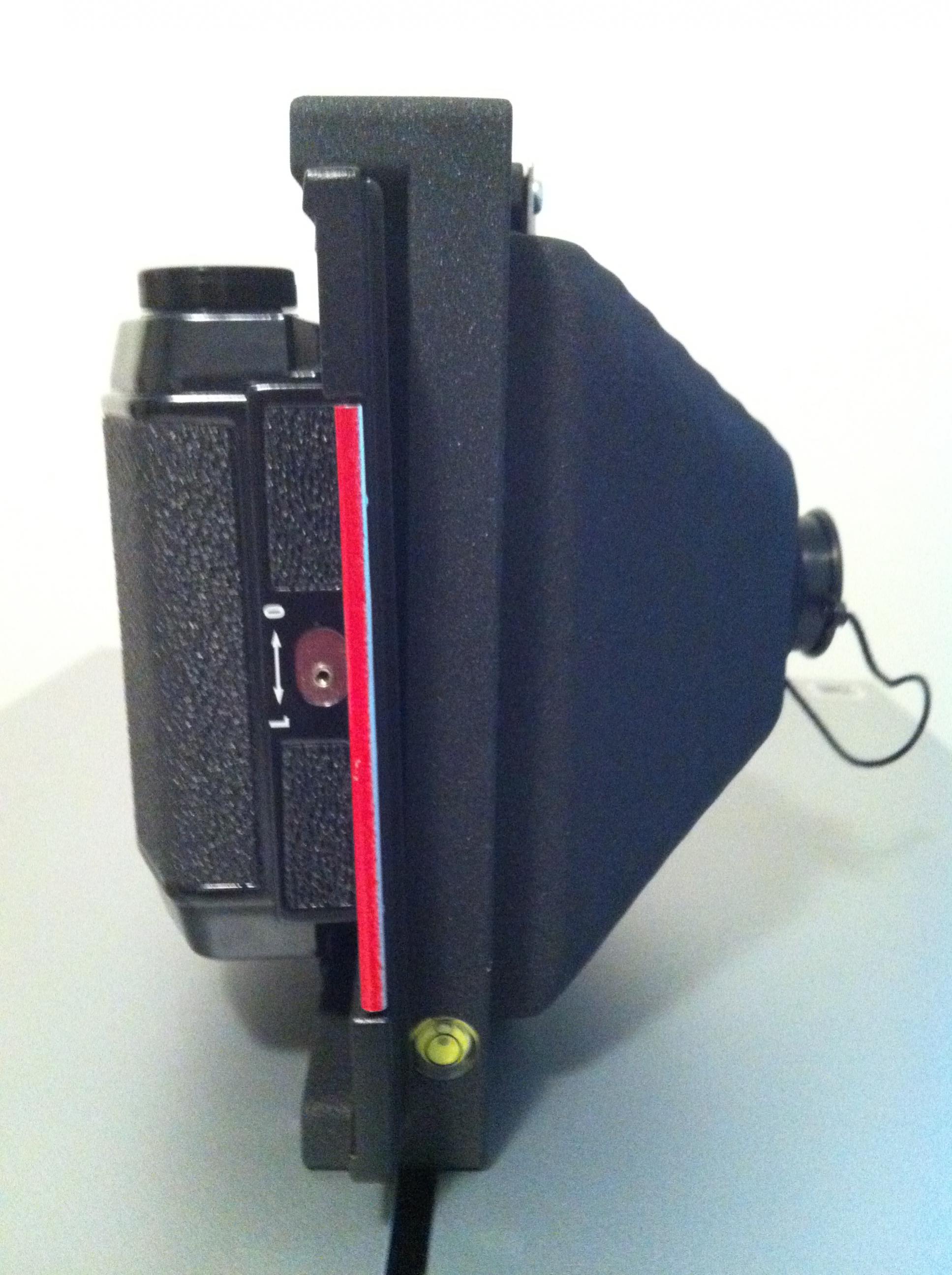

It seems they do 'fit' - but would need some modification to make them snug....
