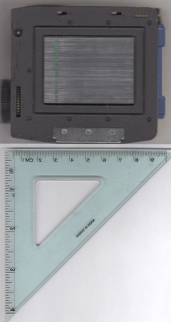

You could also look at the Mamiya 645 Super/Pro backs. They are pretty simple to mount to a camera body.
Sorry, it's the best scan I can get right now. Scanned at 150ppi with the ruler for size reference.
Cool,
Thanks...can you advance the film with the back off-camera?
If so how?
Thanks
The knob on the left side (attached to the gear) will advance the film to the nexxt frame and stop. Then you need to push the release pin (top left) in order to wind it again. If you really wanted to get fancy you could use a handle with a gear to wind the back. I assume that the Rb/RZ backs work in a similar way.
