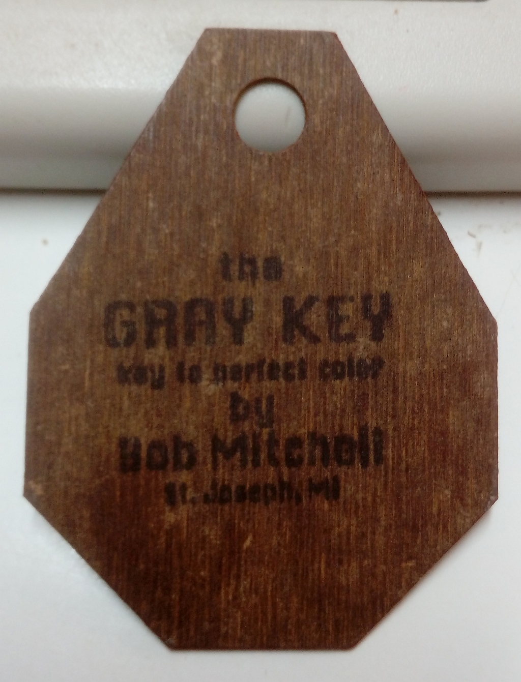

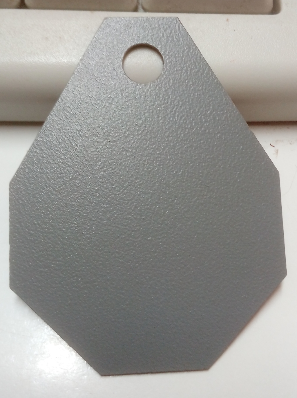

I have been using this Mitchell Grey Key for over 20 years, works perfectly. It isn't a grey card as such, but a piece of laminex type of material that just happens to have the same reflective quality of a Kodak Grey card, or near enough that it doesn't matter.
It was designed to go on a key ring, small and wonderful.
Mick.
