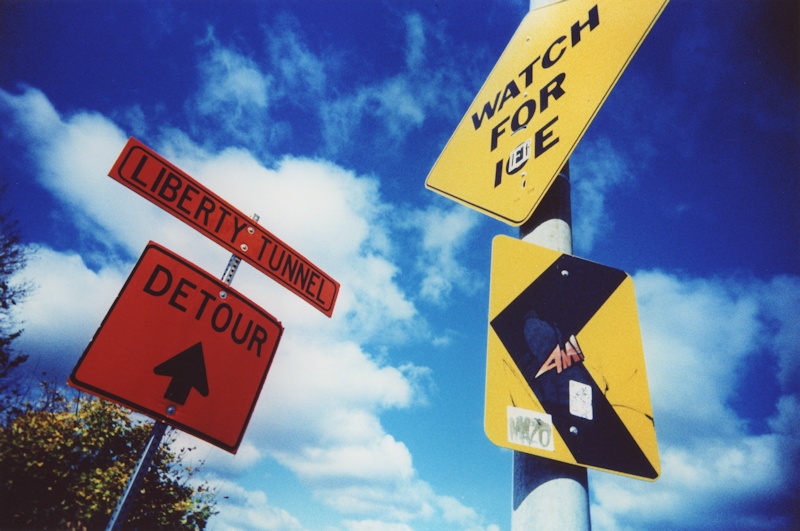

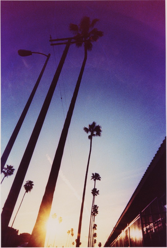

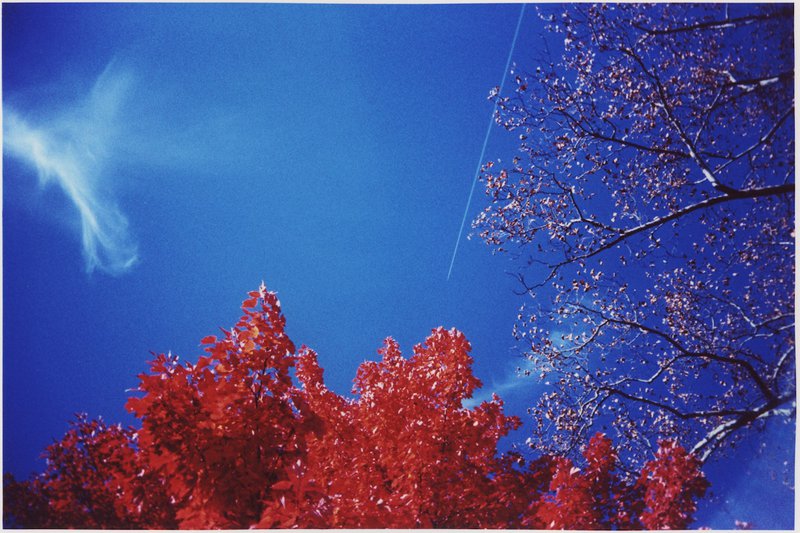

Cross process and wet print. These are scans of 8x10 prints. I'll have to check my notes at home to see exactly what flavor of Ektachrome this is.

Great saturation! Do you print them with a C-41 "blank" negative sandwiched or use filters in the enlarger?
None of the above. Regular C-41 development, straight RA-4 printing. Some from this "series" got some dodging and burning (the contrast is insane!), but not those two particular frames.

Thanks for the reply. Since it's maskless, how much filtering do you dial in to enlarge/contact these?
I have half a box of E100G that gives me muddy colors, I think it's because it's long expired. I thought maybe cross-processing them in C-41 would give me brighter and punchier images.

Sorry for the delay responding. Those got quite normal filtration: 40M+40Y (on a dichroic head). Prints made from other rolls of the same film required quite different filtration. This got 30C+45Y:
By the way, these are all Ektachrome 100 Plus (EPP).

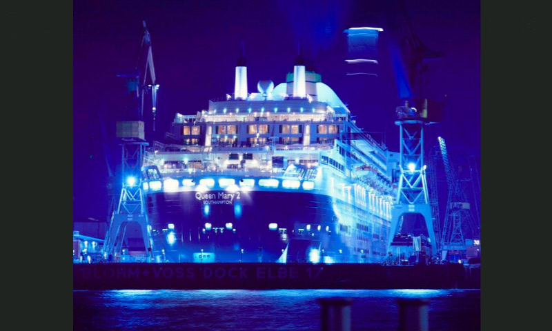

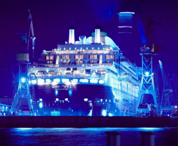

Yes indeed EPP was a real nice film - not so very much different to EPN.
By the time the most remarkable shots from the colors I ever saw was with EPR.
And ISO64 was exact the best to me.
EPY I got very cheap but it has many changes from emulsion due to expired date.But this must not mean that one have to waste away this film :
(EPY 120 total expired with massive lost of dmax and massive color shifts)
but nice........:wink:
