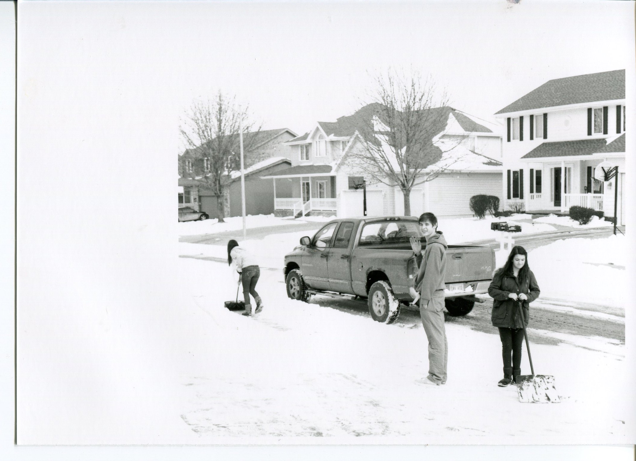

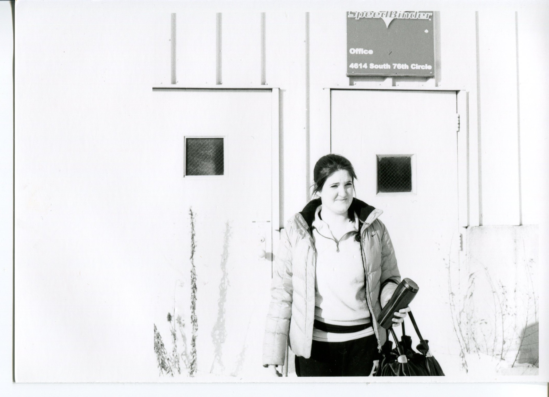

Here are a couple of scans...
The second one was probably a bit over-exposed, in addition to being over-developed.
All things considered, this was an interesting exercise in over-development for me, even if it was an accident.
Dr Croubie
Mar 21, 2013
1,986
rAdelaide
I think that first one works really well as a 'high key' photo. At least there's *some* grey in there.
