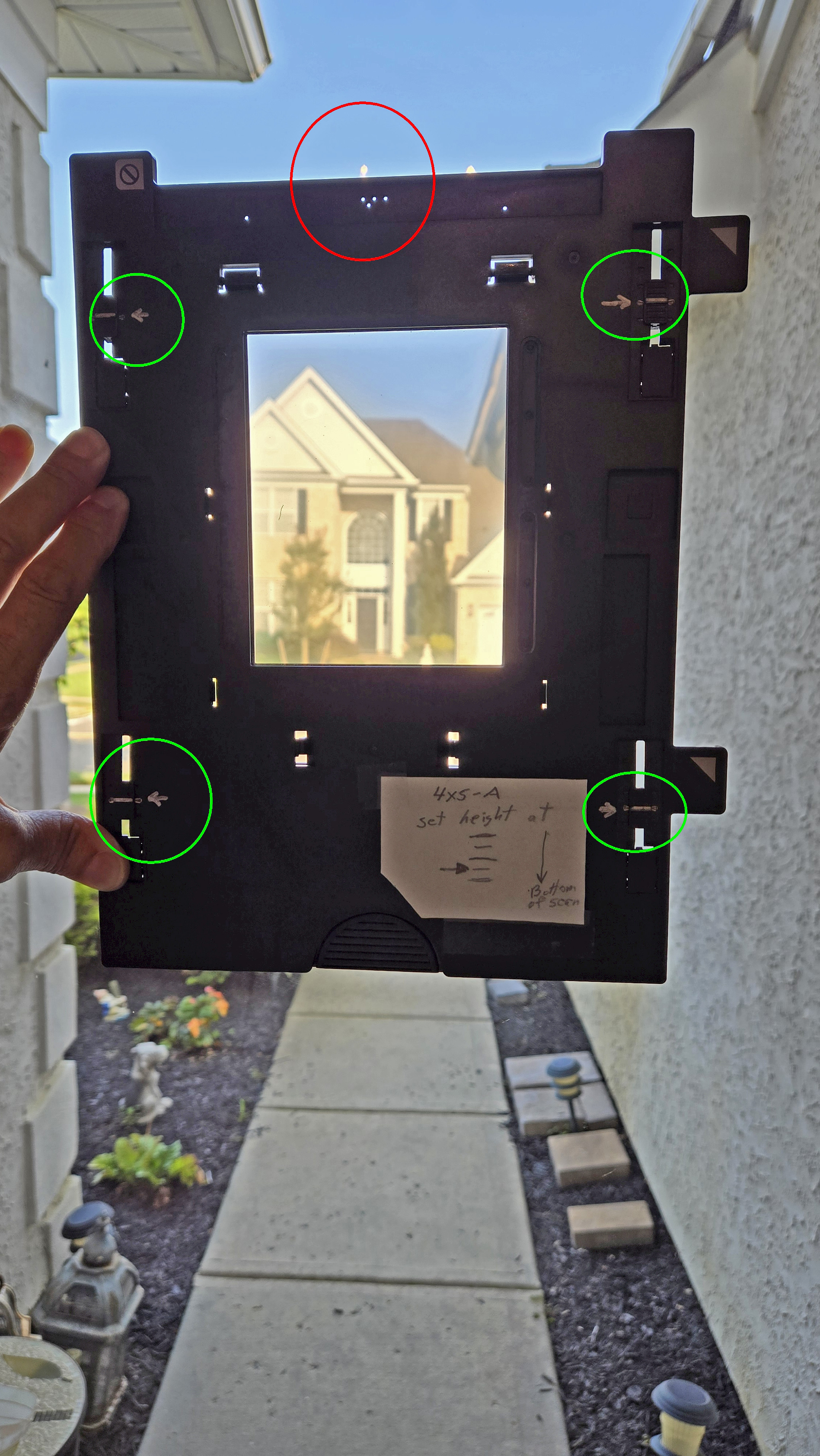

The Epson V850 nominal focus height for their film holders is 3mm. The holders are adjustable in increments of 0.5mm which you should test to determine the best height for your machine. See link below. Page 90-91.
The red circle in my picture below shows how Epson determines which format holder (the example is for 4x5) is being used. Each type has a different set of coding holes. It also tells the machine to use the higher-quality scanning lens. If you scan on the glass, it uses its inferior lens. The green circle sites are how you test and adjust the height of the holders.
I too get more dust with the V850 holder because of its glass-type film surfaces on the holders.

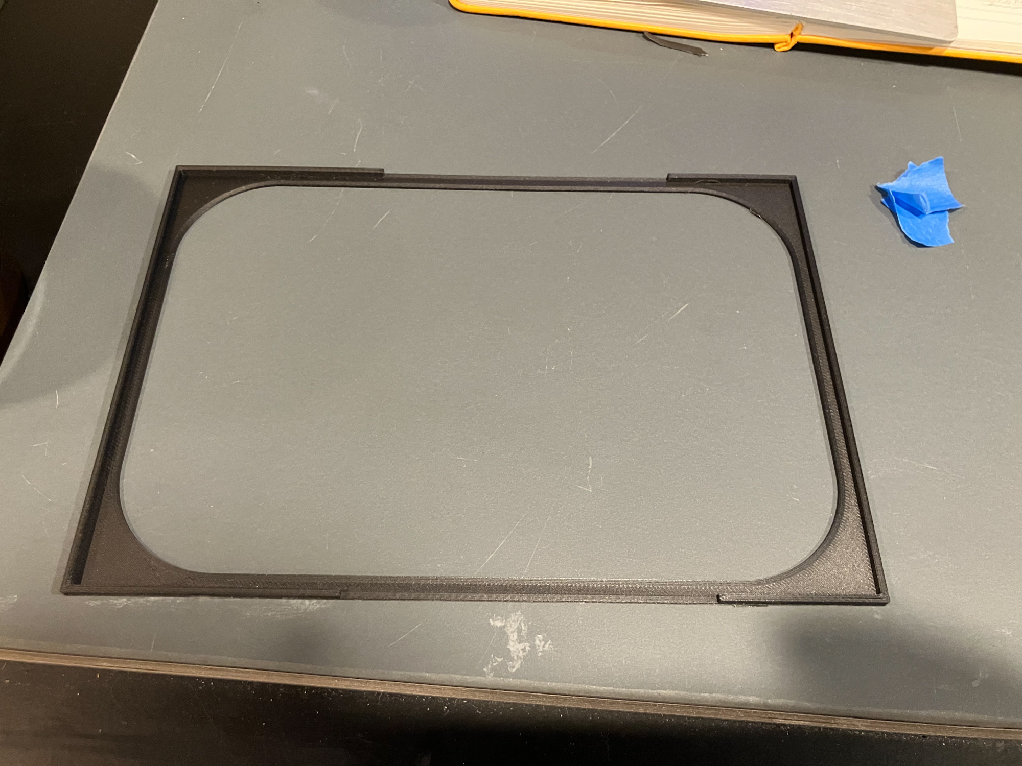

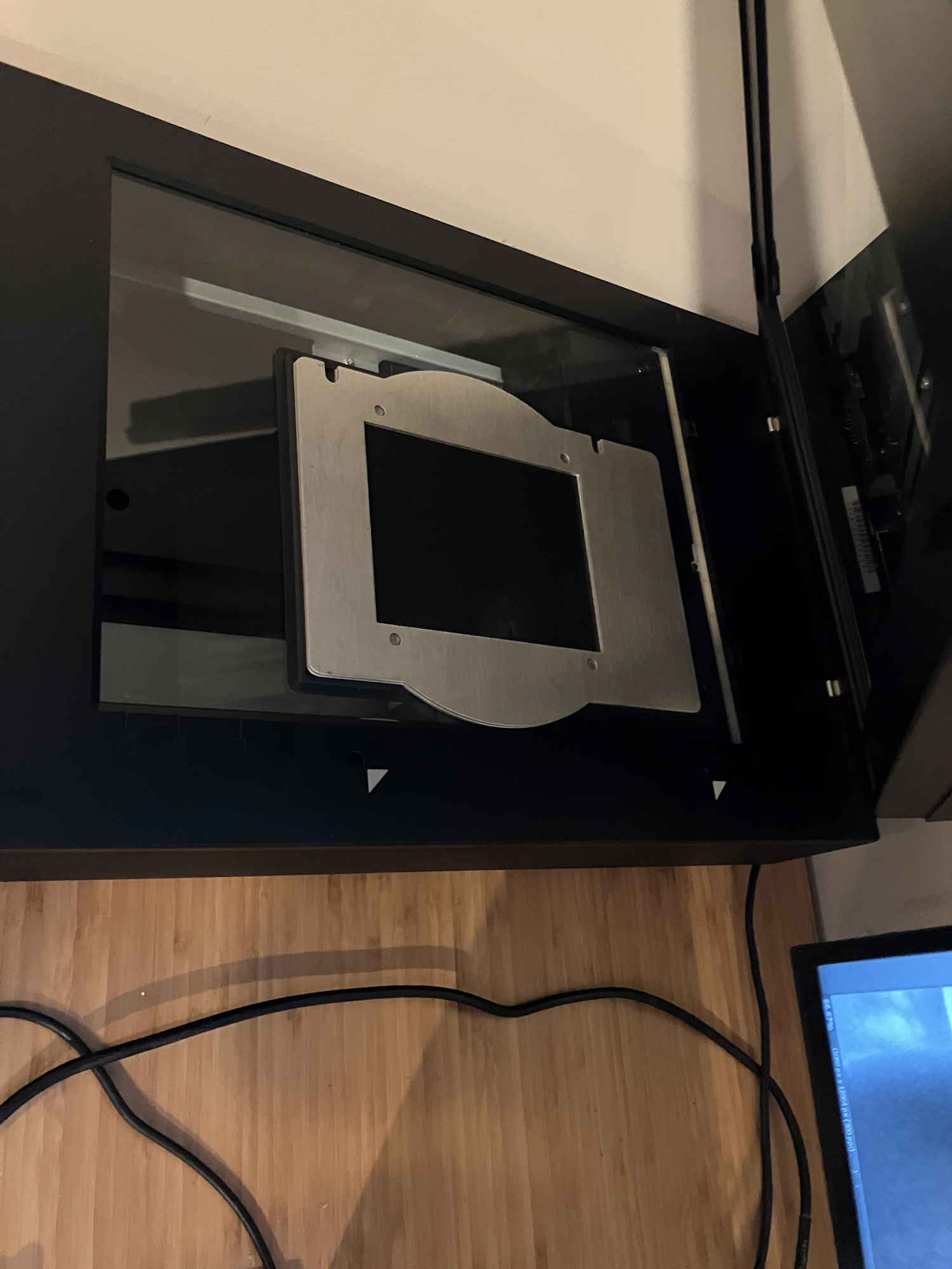

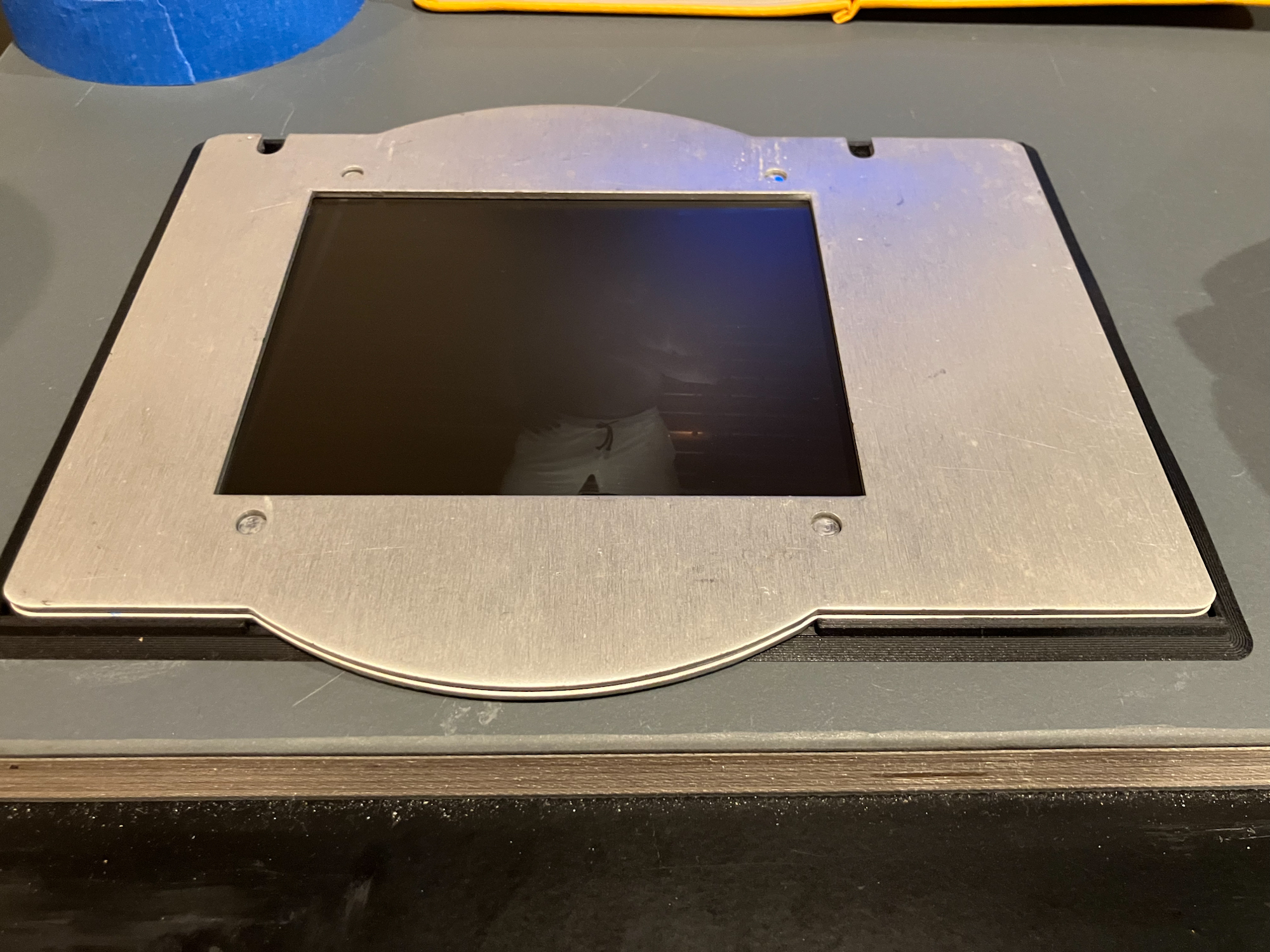

I did a little project this weekend and 3D printed a shim for my omega glassless holders. I didn’t want to bother figuring out the perfect spacing of those holes so I skipped it.
Scanned with Vuescan there was nothing that seemed amiss. Zoomed in I could see no loss of resolution and the negative was focused correctly which suggests to me that the holder lens was being used.
