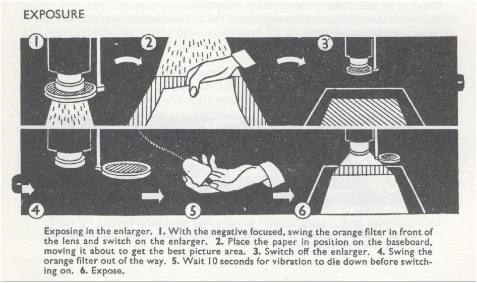

Assuming you don't have an easel... 1. With the negative focused, swing the orange filter in front of the lens and switch on the enlarger. 2. Place the paper on the baseboard, moving it about to get the best picture area.
I've always made sure I had the accessory red filter for every enlarger, but have never used one.
It seems so logical and obvious what it is for. But what's never made sense to me is why you would ever need one.
While browsing through O.R. Croy's "The Complete Art of Printing & Enlarging" I came across this illustration.
And suddenly it made perfect sense.
Amateurs did not always have an easel.
I always have had one.

Gents, I need to shed a bit of ignorance here. 'Having not printed for decades, I don't see from the illustration or discussion - what is made possible/easier w/ the filter than without. The unfiltered light will show the image area, where to position the paper. If its reduction in light for use w/ unexposed paper, is it just more contrasty than stopping down 3 stops? Or is the red close enough to safelight to allow a no-risk positioning of unexposed paper?
Its a noob question, but I'd rather ask than stay ignorant.
Svenedin
Mar 19, 2016
1,191
Surrey, United Kingdom
Med. Format RF
The red filter is the equivalent of "safe light" and should not fog the paper (providing it is the right kind of filter). Using the red filter means you can project a red image onto the paper for proper positioning without an easel frame or to identify parts of the image that need an extra bit of exposure ("a burn") or indeed parts of the image you want to dodge. I can confirm mine works as several times I have absent mindedly forgotten the red filter is in place and then wondered why the paper is completely blank when I try to develop it.

Ah. Svenedin, Thank You - the safel light. *That* makes sense. I would think the enlarger light source would need to be on the mild side.
