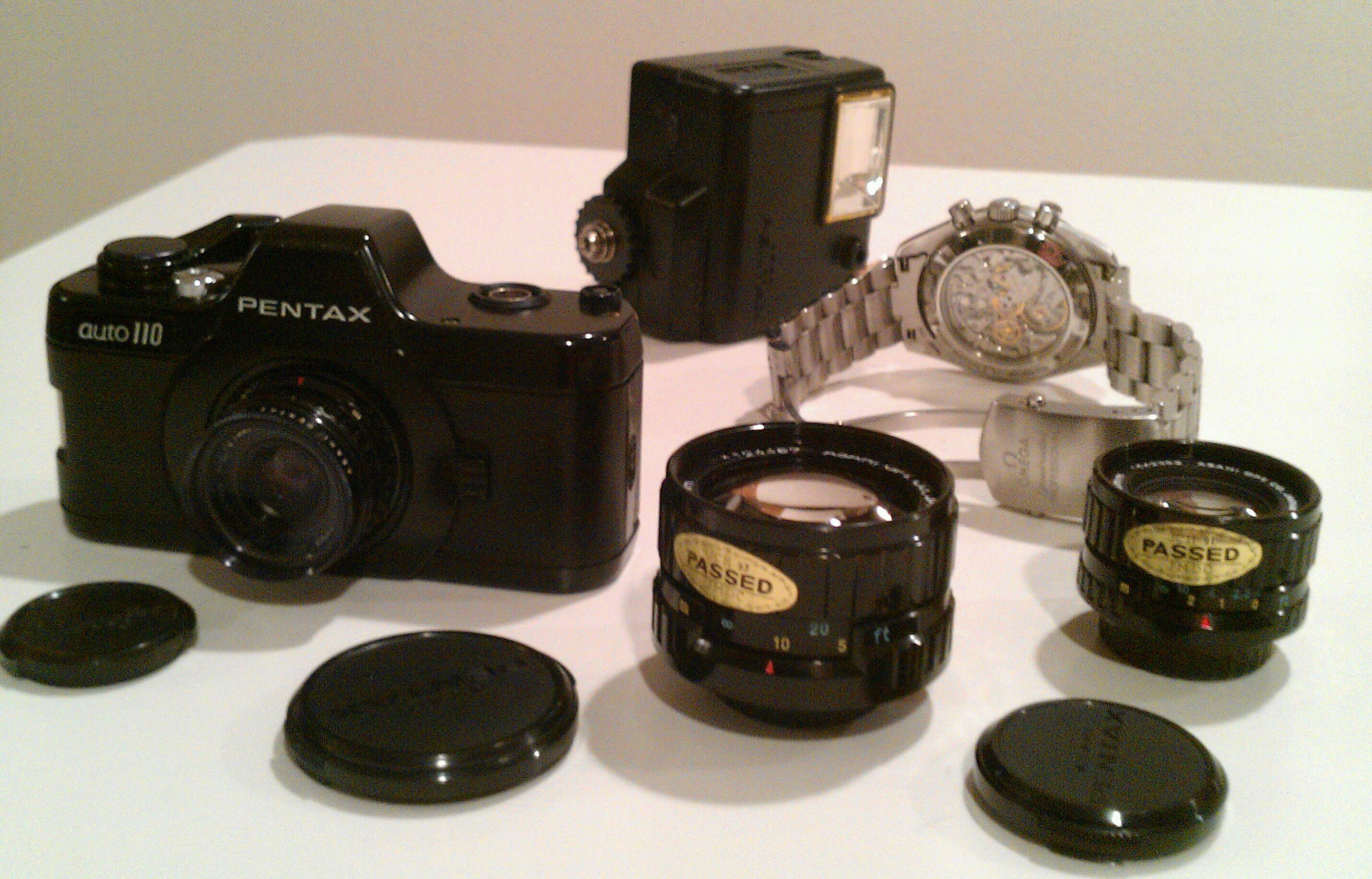

I have the Pentax 110 with three lenses; it's fun to use because the entire system can fit in a small pouch.
I use the Lomography film. My belief is that the film is sitting too far back, because objects closer to my focus point are in better focus. I may do as one person did and insert a shim between the film and the inner back of the cartridge to force the film about 0.2 mm closer to the lens.

I shoot my Pentax 110 about once a year. I have 5 of the 6 lenses plus the teleconverter.

I've just picked up a Pentax Auto 110 at a car boot sale on the weekend. Ordered some film for it and looking forward to trying it out, looks like a fun camera to use. I have the 18mm 28mm and 50mm lenses.
There was a problem with the winding mechanism (seemed jammed) I took off the bottom plate and one of the cogs had come loose, I set it right and all working now
