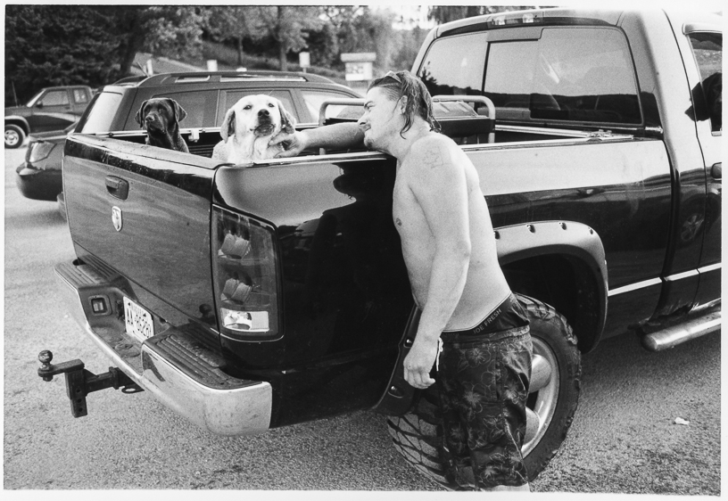

Scan of the 8x10 print, camera lens aperture was f1.5.

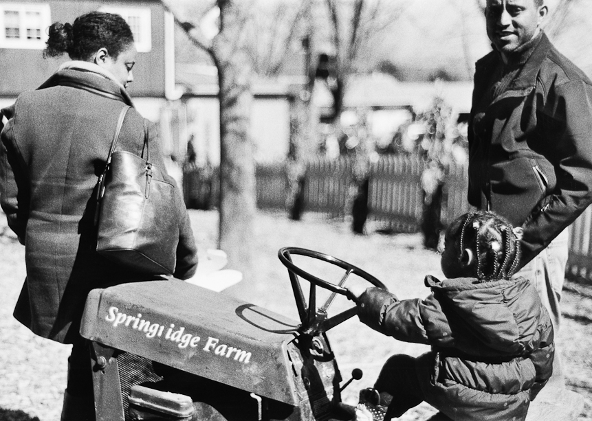

Scan of 5x7 print and lens on camera was with f5.6 of f8.

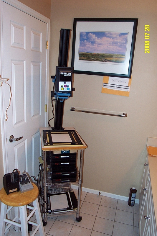

My Beseler 67C, with colour head, on a microwave cart in my bathroom/darkroom:
It currently is in storage, because I'm using an Omega D6 as my main enlarger, but I'd be happy to go back to it.
Note the extended column. I'm not sure, but there may have been versions with a shorter column. There definitely is/was a version with a double column, like the 23C.
