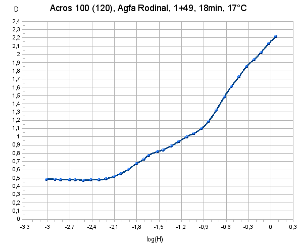

This is one of my first experiments with Acros, Rodinal, low temperature and minimal agitation:
The curve shape is very peculiar. Perhaps I need to repeat it.
