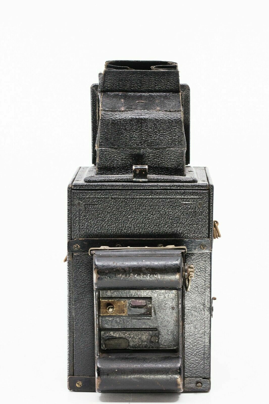

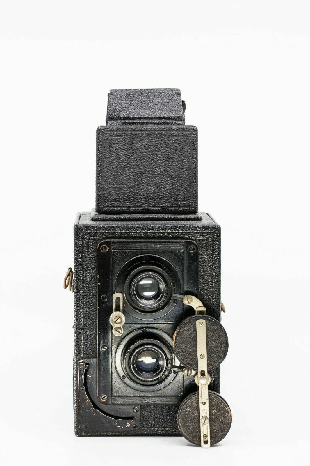

Seller says Strand is a typo.
He meant "Strange".

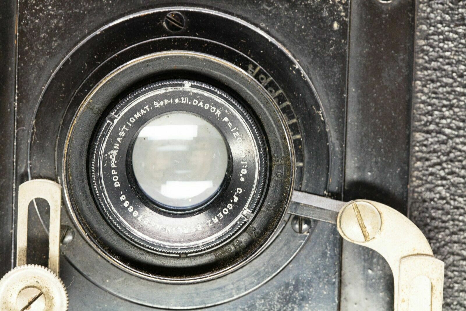

Lenses and mounts look like ones from a Goerz Anshutz Ango.

Well it's no earlier than 1904 when Goerz first used the Dagor brand name, and checking there were at least 8 British TLR cameras by 1898, the first made in 1895. So one would expect similar German cameras.

The film back says Rollex Patent.
Is that a German brand?

Me too...
However the early models called "Rollex Patent" were made by Balda.
AFAIK rollex was a german brand indeed, it was balda who made these in the old days. and yes, linhof and plaubel made them quite known. the super rollex were linhof, I don't know if these are re-branded.
the roll film back seems to be integral part of the camera. 120 roll film and rollex backs became popular after 1915, when a court ruling stated that kodak was neither the inventor of roll film nor that any of their pretended patents were valid.

Rollex became part of Linhof after WWII, and Rada became part of Plaubel. So the answer to the OP is yes a German brand, however I suspect the Rollex back was added later as I seem to rember seeing them in the New Goods section of a 1920's British Journal Photographic Almanac, so I'd suspect originally it use 6.5x9 plate holders, a film pack, or a different roll film holder. Just a quick check and itappears Rollex backs seem to have been itroduced around 1929, they are in the 1930 BJPA and may have been made by C. Niethold A.G.
The Ebay seller states it's a prototype and he may well be right as there's very distinct similarities to the Goerz Anschutz Stereoscopic camera in terms of the linkage and way mounted etc.

...The Ebay seller states it's a prototype and he may well be right as there's very distinct similarities to the Goerz Anschutz Stereoscopic camera in terms of the linkage and way mounted etc.
Ian
if I look at the camera, I would say that this is not a prototype. it seems to me that there was probably a a sheet film or glass plate version. the housing is well designed for a single plate camera, to which a roll film back was added. seen the popularity of goerz lenses and rollex backs this could well be non-german.
