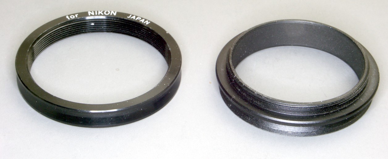

Both adapters simply have backs to be attached with pins/screws. I'll take a picture. These are unusual.

Here are the mystery adapters. The one marked "NIKON" has a 4?.?mm female thread, and the other a matching 4?.?mm male thread.

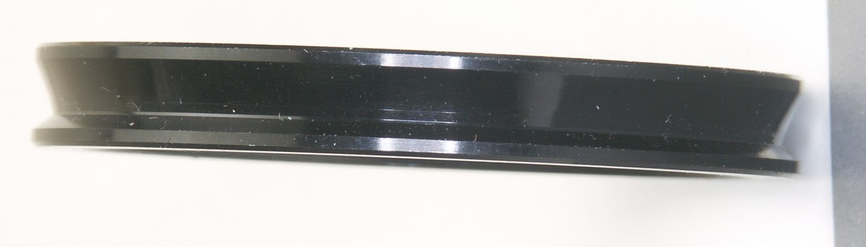

The other photo shows what the opposite side looks like --from the side. It is designed to attach to something that has three pins/screws -- much like a T-2 adapter -- that push up into the groove and grab it.

I think I've figured out the problem. The 42mm adapter that I was using to test these two mystery items is defective. To my eye the threads look fine, but it must be warped, and won't fit.
So I got another 42mm item which fits fine.
Sorry for the trouble!!!

FWIW, T-mount adapters have the exact same markings
My guess is that the "for Nikon" piece is part of an adapter that connects a macro bellows/slide duper to a Nikon via a T-mount.
Some T-mounts are 2-piece, and have set screws that ride in a v-shaped groove so that camera/lens/slide stage all align properly.
I believe your "for Nikon" ring is one piece of a 2-piece T-mount.
