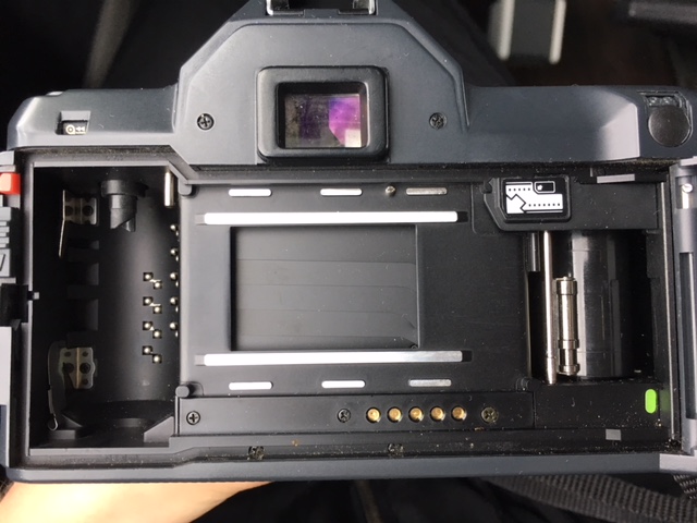

The Pentax P3/30 series slrs have manual film advance but w that P&S auto loading.
There are plenty of newer film cameras that are inexpensive and don't use the sprockets. Maybe there is a list on-line somewhere. As mentioned, some are Pentax/Ricoh with a K mount. Minolta made some too, like the Maxxum 5 that you can find for $20 or so -- but if you have K-mount lenses, stick with Pentax/Ricoh.
