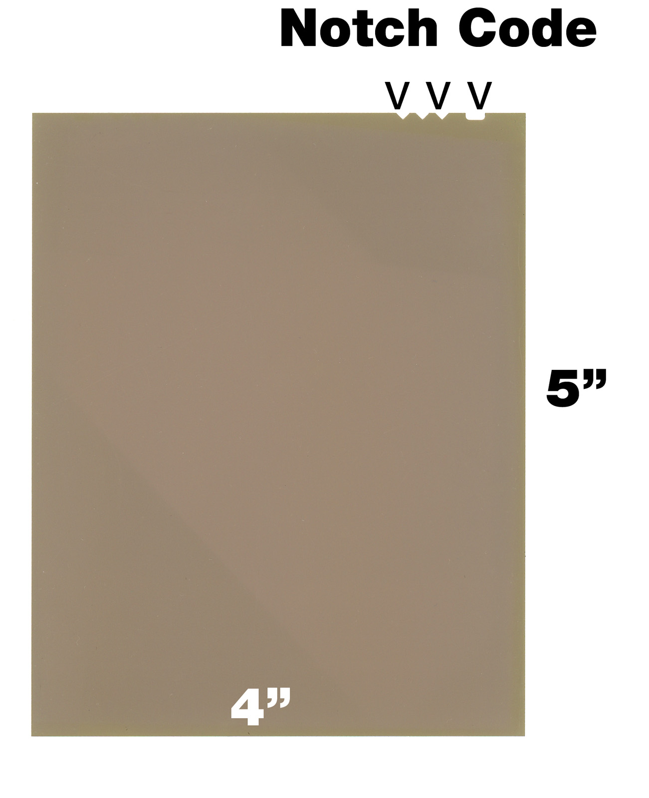

Generally, mixing C41 and E6 films in a single shoot is a recipe for disaster. I highly recommend you
exercise extreme caution. Fortunately, if you didn't know it already, each film type has a series of
corresponding notches on one of the edges which is pictured on the actual 4x5 film box...so just be
sure you don't make a mistake. Another thing to think of during your shoot is exposure readings...
be sure, if you're sharing a meter, that you meter with the correct ISO.
One other thing, be sure you load the sheets correctly...if the holder is sitting flat in front of you, with
the top of the film holder towards you, the notches should be on the bottom right of the film holder.
If using a dark-tent/bag, you can never be anal enough when it comes to cleanliness and being dust free.
I kept our changing tent cleaner than an operating room. LOL.
As stated above, load exposed sheets in the correct and LABELLED box within the box and then tape
all edges of the box with black gaffers tape. Be sure to LABEL the box. I've loaded thousands of
sheets when I was an assistant, and always did it the same way...I am a little OCD when it comes to it.
