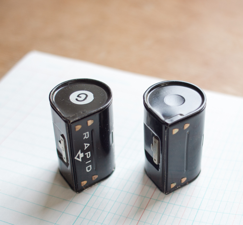

maybe a bit out of TS but I have these two:
found it in my Dad's camera but how to open/load/reload these cassettes?!
If I understand correctly - you don't open them - you have one full and one empty...it goes from full unexposed to empty exposed. Then you take full exposed cassette - the end part of the film is still out, and pull the film out (in the dark), and develop it.
If both cassettes are empty - you need to load one with the film (in the dark). There is no take up spool in the cassette.
Completely right.
Only issues are to cut the leader end smoothly to make it feed itself into the opposing cassette-
And to mark the leader, to be sure not to mix it up with the tail of an exposed film.
ok thanks! Both cassettes are empty; so how to fill one & how much 35film goes in & how to 'lead' the film into the take up spool? i'm a novice in this 'rapid region'; 2001 my Dad died, I put these spools into my bureaux & never looked at them again. "RAPID" wake me up :smile:
Very nice looking camera btw !!
EDIT: I would say 1 meter (cca 24 exp 24x36). You cut in the dark from a roll, and slowly push film inside until only cca 10 cm is left.
The Rapid etc. systems (cassettes and cameras) are made for 12 exp. at 24x36 (resp. 24 at 18x24). Thus using a longer film strip means wasting film. As the cameras typically block releasing after the last frame plus a stroke to get that into the cassette, to avoid exposing with film having ran through.
However some models (as the Penti) lack this blocking. Here one could try to squeeze more film into the cassette at loading.

Information: Before I had a second Rapid cassette, I just (in the dark) put a roll of film in the supply chamber, engaged into my (then) only cassette on the take-up side, and all went well.

About the cassettes:
-) Karat = from sheet metal
-) SL = basically like Karat, but from injection moulded plastic(from GDR/USSR)
-) Rapid = Karat, but with recess taking stud for film-speed indication
The film itself is classic 35mm, but the shaftless cassette is different.
Cut off the beginning of the roll of 35mm film such that the end is full width, and cut the end to be slightly rounded, and make sure neither if the perforations are open (that is, the perforation is surrounded by acetate)
In a dark room, push a short run of film into the cassette until you have about 6cm left hanging outside the cassette (that 6cm becomes the film leader).
It's best to divide a 135x35 roll into three rolls, since a longer roll will make it difficult to advance near the last exposure.
