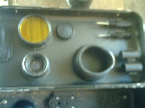

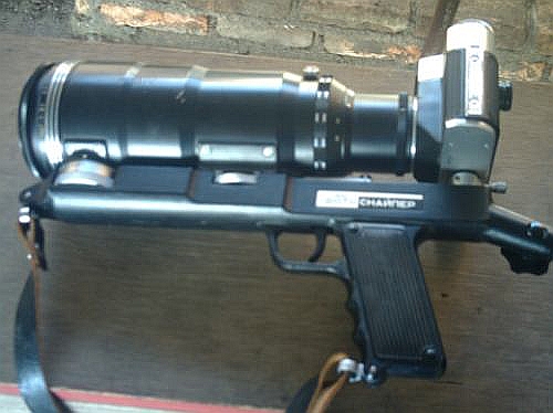

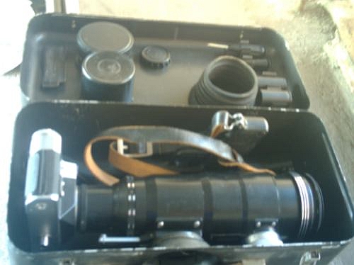

I´ve been offered this item by an antique collector who does not know any details about it. Can someone help? Pictures from the seller, not mine!

It's a Zenit Photosniper. they used to be sold in the UK by the official Russian camera importer TOE (Technical & Optical Equipment)
Basically a Zenit E with a 300mm lens fitted to a pistol grip which made the whole thing easier to balance for hand held work.

Looks to me like a Fotosniper FS-3 kit, sold as a complete kit by KMZ from 1965 to 1982. The body is a Zenit-ES, the tele lens a Tair-3AS 300/4.5, and it also came with a Helios-44 58/2 lens, and 5 filters. No, I'm not an expert - I found it in my copy of Princelle, page 173.

It's a Zenit E Photo Sniper, Outfit they may have been used by the Russian Military I don't know, but they were available in the U.K about twenty years ago in camera stores, we used to sell them in the stores I worked in, they were imported by a company called Technical And Optical Equipment, the 300mm Tair 3 is a pretty good pre-set lens and it should also have in the kit a 58mm Helios lens. If you decide to buy it be careful where you use it, I stupidly once used one in Belfast during " the troubles" and nearly got my head shot off by the British Security Forces because it looks so much like an AK 47 from a distance.
