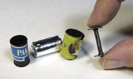

I have a very old film that was shot in the 60th and still not developed, so maybe gone, but I tried with a few others almost as old and got pretty ok negatives, the problem is that I have no idea what kind of film it is.
It's a tiny 16mm film from one of those little spy cameras, I would guess they used 16mm movie camera film and cut it down, can't find any information on the film roll either, not even the brand, the end paper is pink with blue text "Ende / closed" but I don't think that is much help.
So without knowing anything about the film type, would there there be any "safe" way of giving it a try to develop it ? or anyone have a clue to what kind of film it might be ?

Yes, that is a possiblity but most of them are 8x11mm film, this is just like a very small 120 roll film, about 8mm in diameter and 18mm long, the film is 16mm wide, don't know the frame height

If the roll looks like a tiny version of 120 film, it might be for those toy "Hit" cameras that were popular through mail order comic book ads back in the 60s.
A relative gave my one of those cameras along with a couple of rolls of film when I was a kid. Don't remember what happened to the camera or if I shot any of the film before I lost track of it.

We need a picture, but from the description I agree with desertrat; "HIT" film. Are we correct?
