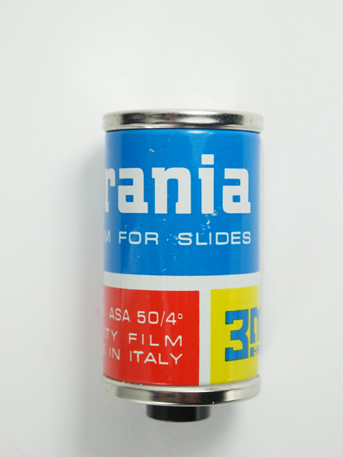

Hi all,
I found a set of old cameras at a "garage" sale, and I was surprised to found a film still in one of them, a nice Walz Envoy M35.
Here is the roll :

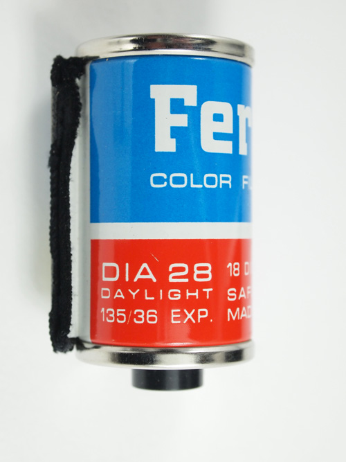

It's obviously an very old Ferrania dia film. But I have some questions :
- Is this emulsion can be processed by modern E6 chemistry ? (or it's E4 ?)
- Is there any chance to salvage some pictures ? I presume the latent image long gone ago, or the camera opened during all theses years, but I am curious !

Get a clip test - the lab processes a few frames. You can assess those results to know how to proceed.

It's not E6...that would ruin anything on the film, and could contaminate the lab's chemicals. I think it's one of the post-war films based on the old Agfa color chemistry. One of the specialist labs could handle it, e.g. Dead Link Removed

A little digging around suggest that Ferrania "Dia 28" film is mid-1960's vintage.
Some other digging around suggests that E-3 wasn't phased out until 1974, so that almost certainly makes it E-3 if it's not a Kodachrome-type film
So I would guess your best bet is to process as B&W.
FYI--In digging around, I came across this document:
http://www.kodak.com/global/en/professional/support/techPubs/cis111/cis111.pdf
Which provides instructions on how to scratch-mix E-4
--Greg

If it is E4 or earlier, then it will ruin the E6 process as the film emulsion will come off the support at the high E6 process temperature.

If you do try E6, then watch the temperature, some of those ancient process films, can't take the heat, instead of 38C, you might find 25C more to the films liking, of course that means that you need to shift the times, but base fog probably means you need to do that anyway. Personally I would just process as a B&W negative and be happy I got something out of it.
