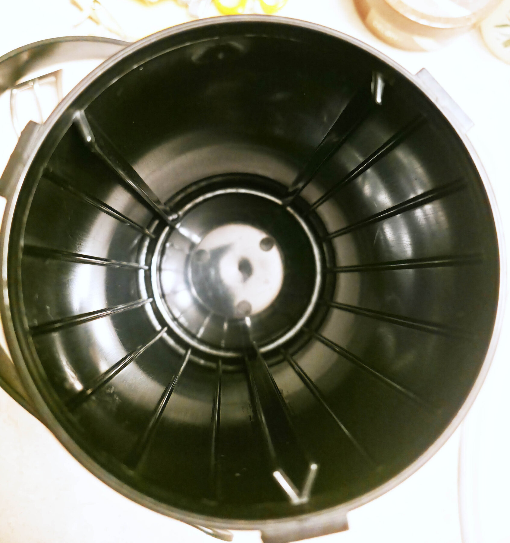

I have one of these units, but I'm unable to use it due to the missing lid gasket. Short of buying another one of these tanks, does anyone know where I can get a suitable replacement gasket? I'd hate to have to throw the tank out just because of a missing gasket.

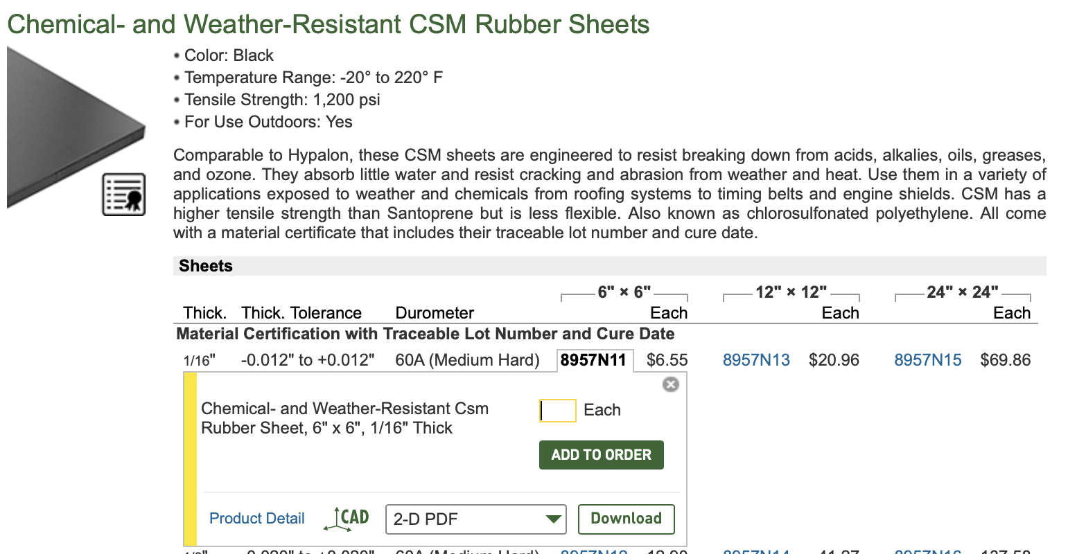

Mcmaster carr has a number of rubber sheets that would work. For example this:

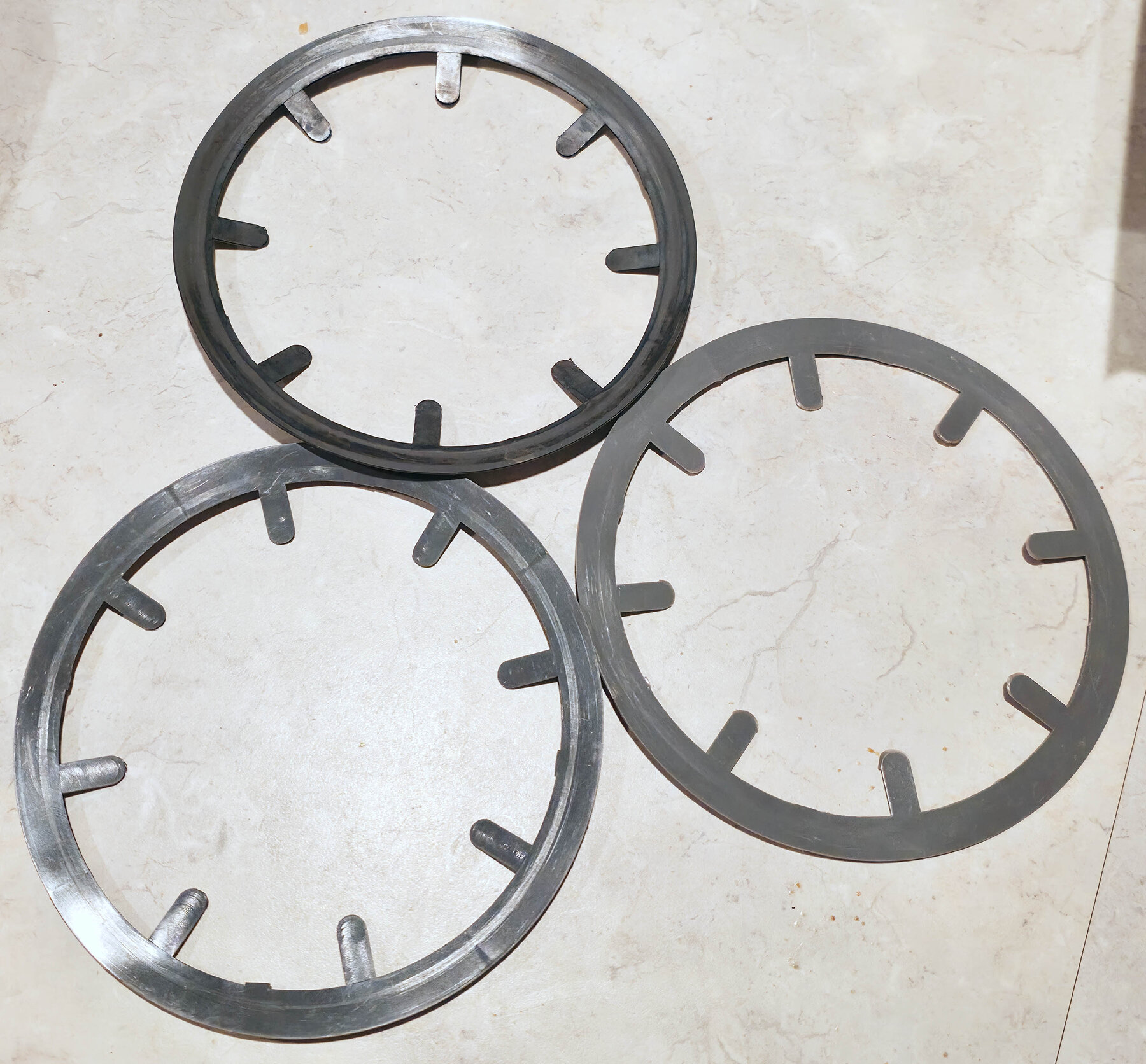

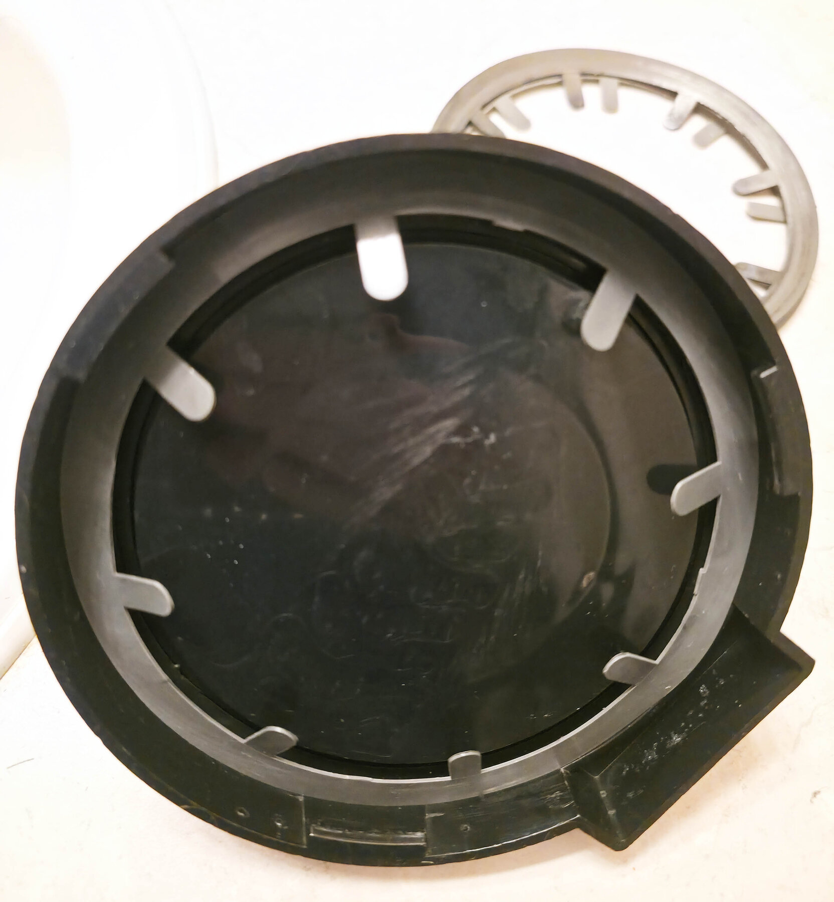

Robert got a hold of me again and shipped off his gaskets he had for this drum. I received them today. Thank you Robert! They fit perfectly and have 2 extra for spares incase the one I installed starts to leak.
