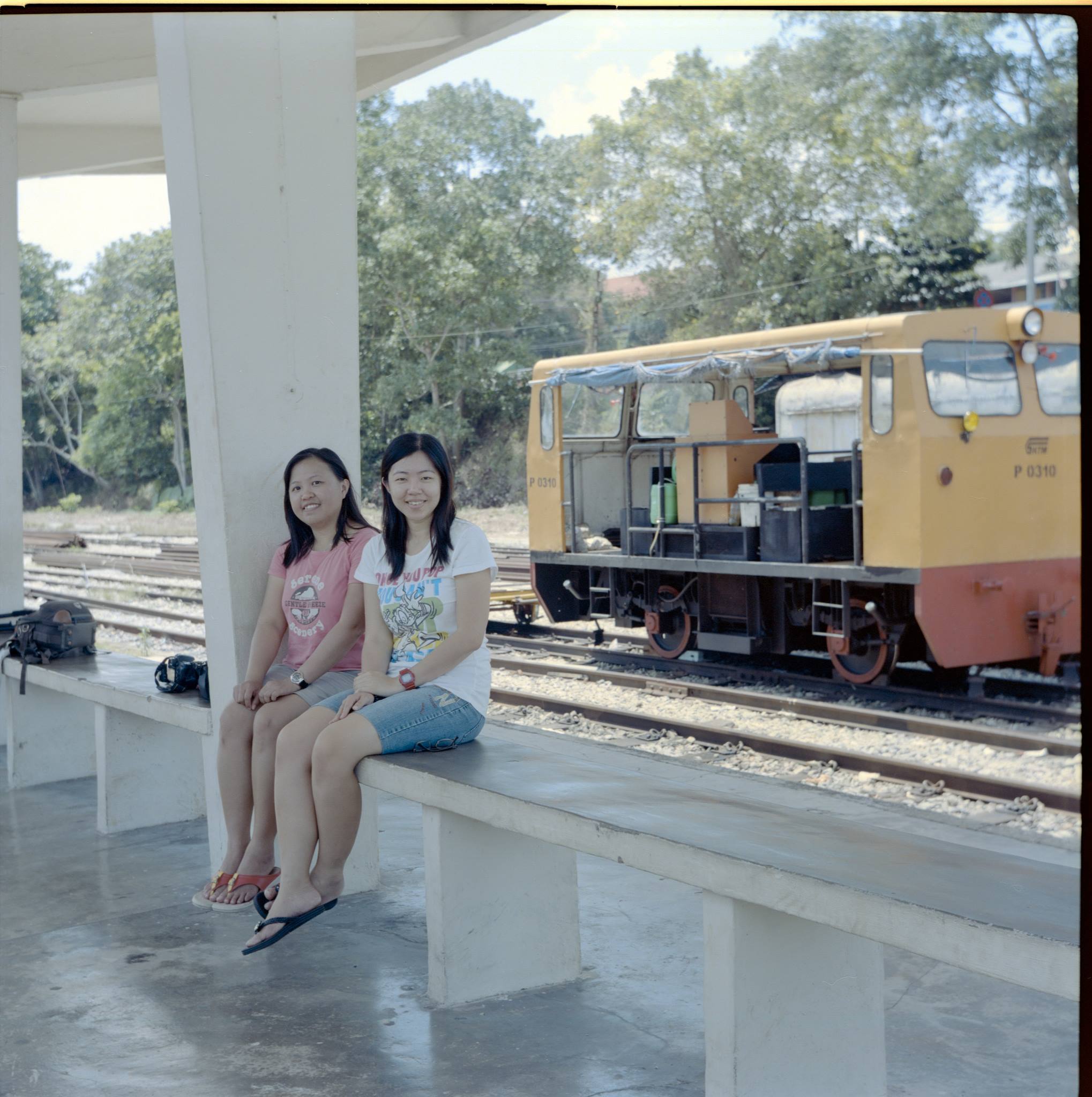

Hi all,
Just developed my first roll Kodak pro 160 , 6X6 format using Unicolor C41 kit.
I follow instruction carefully. Scan using Epson V600 and vuescan.
seems something wrong, any one help me please?

Looks fine to me. Getting colours right from colour neg scans can be quite hard. Try opening the tiff in Photoshop and play with Curves to see if you can get a result you're happy with.

Hi eriklovold ,
thanks for reply. I'm using vuescan for years, I scanned a roll of commercial developed film yesterday, with good result. Anyway, thanks for your idea, and I will try to edit tiff file and see if I can correct the color fading problem.

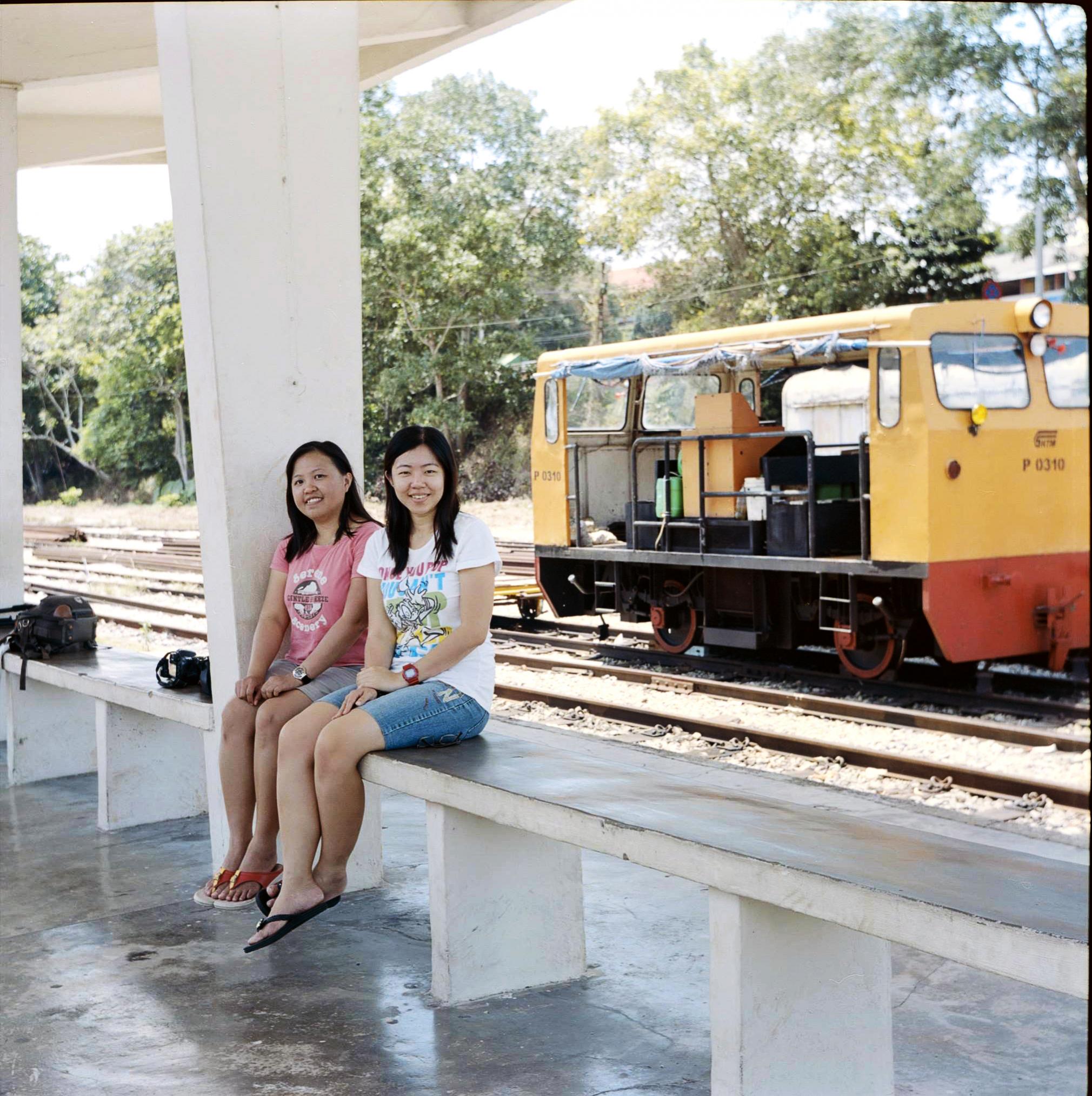

here's the commercial developed film , and I scan it with epson V600.
Regards,
Ew
ewsphoto
Feb 6, 2012
6
hi,
color corrected in photoshop. looks much better now. thanks !

Color negative film can register much higher contrast than a JPG file or photographic paper. When you scan negative film, and especially with motives that have a high scene brightness ratio, the scanner post processing software will compress contrast to make it fit into 8 bit color space. As a result, the image will look faded and contrastless, just as if you print a b&w neg on gradation 0 paper. Get the negs printed optically and you'll see that colors are most likely fine and dandy. If you insist on hybrid work flow, plan for digital post processing on your computer.

Nah, it's just (well mostly) wrong gamma, which causes that milky look. You do a wet print and it won't look like that at all. You do the scan right, it won't look like that either.

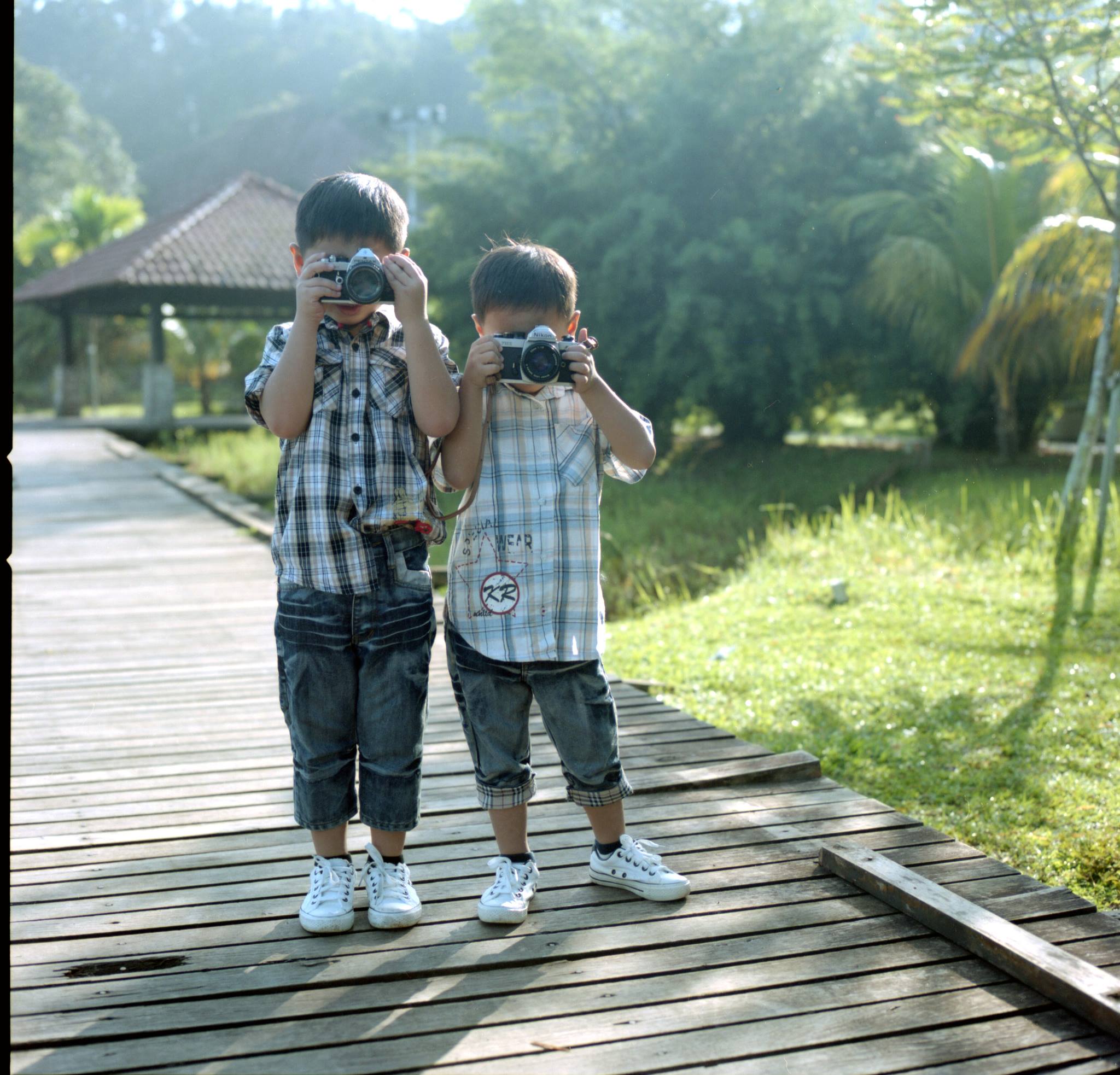

These are both scans from C41.
