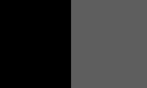

take a look at this image and tell me if the two halves are constant tones or does one side have a light gradient towards the join?
then copy the image and measure the tones with your graphics software and see whether what you see is actually what is there.
p.s. this image has never been near a camera or any developer of any sort. It is computer generated.
You are correct of course. It does appear that there is a light gradient near the join, but in fact there is not. Using the dropper tool in Paint Shop Pro, anywhere you measure to the right of the join, the numbers are the same: R=94, G=94, and B=94. To the left of the join the numbers are 0 for R, G, and B. So yeah, your reply does illustrate an optical illusion. Very clever. It is possible that that the OP is also seeing an illusion, but I can't be sure. Truth be told, we know very little about the image. We have no information about the time of day, the condition of the sky (overcast overhead with clearing at the horizon), position of the sun, etc. I don't think it is a development problem, and I really don't think it is a problem with the enlarger's light source.
